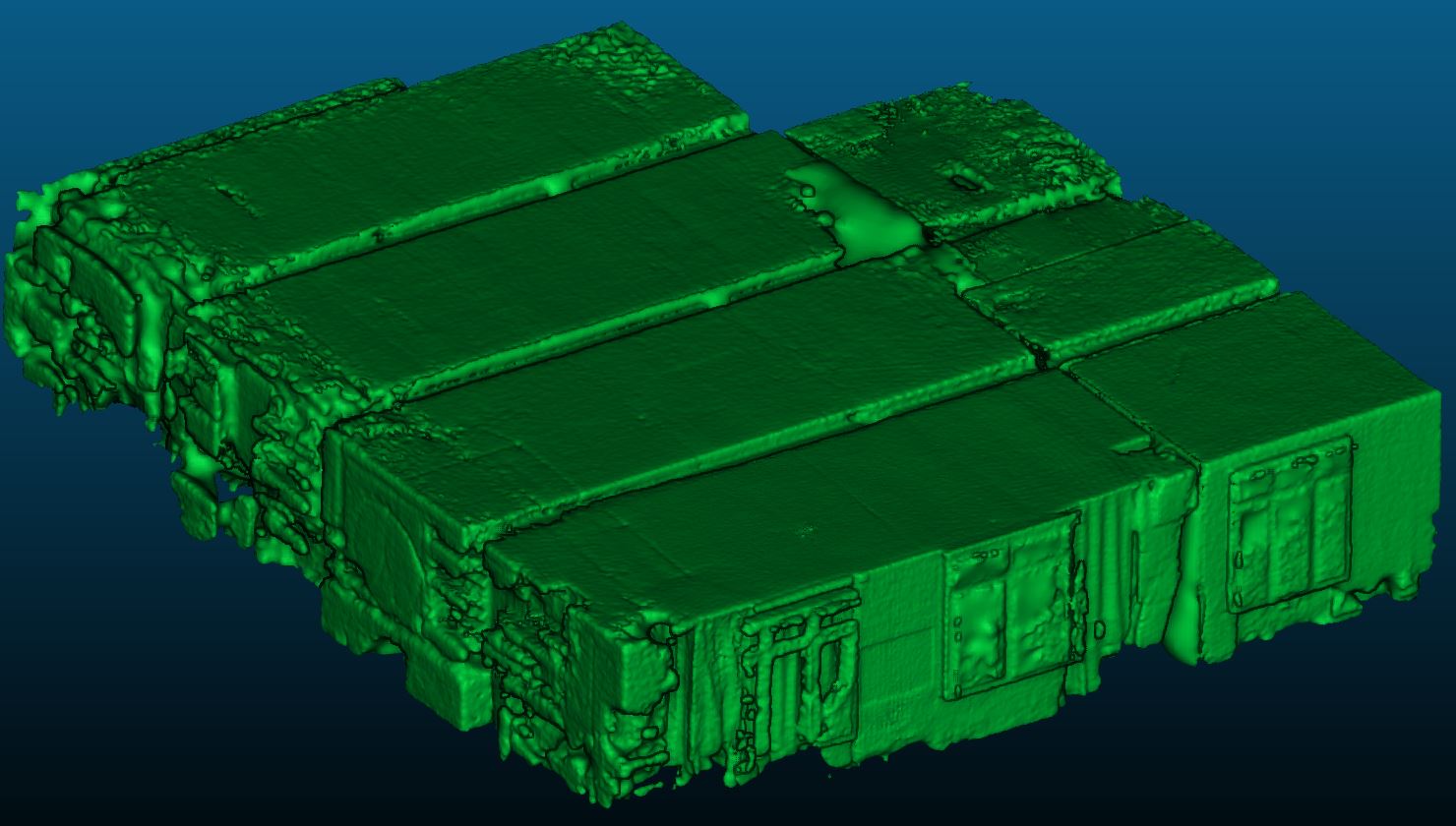

Ok, the noise is quite big, and meshing complicated structures without clean normals is always a bit hard.
Anyway, here is what I did:
1) first, remove the noise: I used the SOR filter (https://www.cloudcompare.org/doc/wiki/i ... SOR_filter - default parameters)
2) I computed the normals (Edit > Normals > Compute), with a radius of 0.05 and a preferred direction of '+Barycenter' (which means that most of the normals will point towards the barycenter which is approximately at the center of the room)
3) I eventually used the Poisson Reconstruction plugin (here with a level of 10 - the noisy parts are of course harder to reconstruct properly)

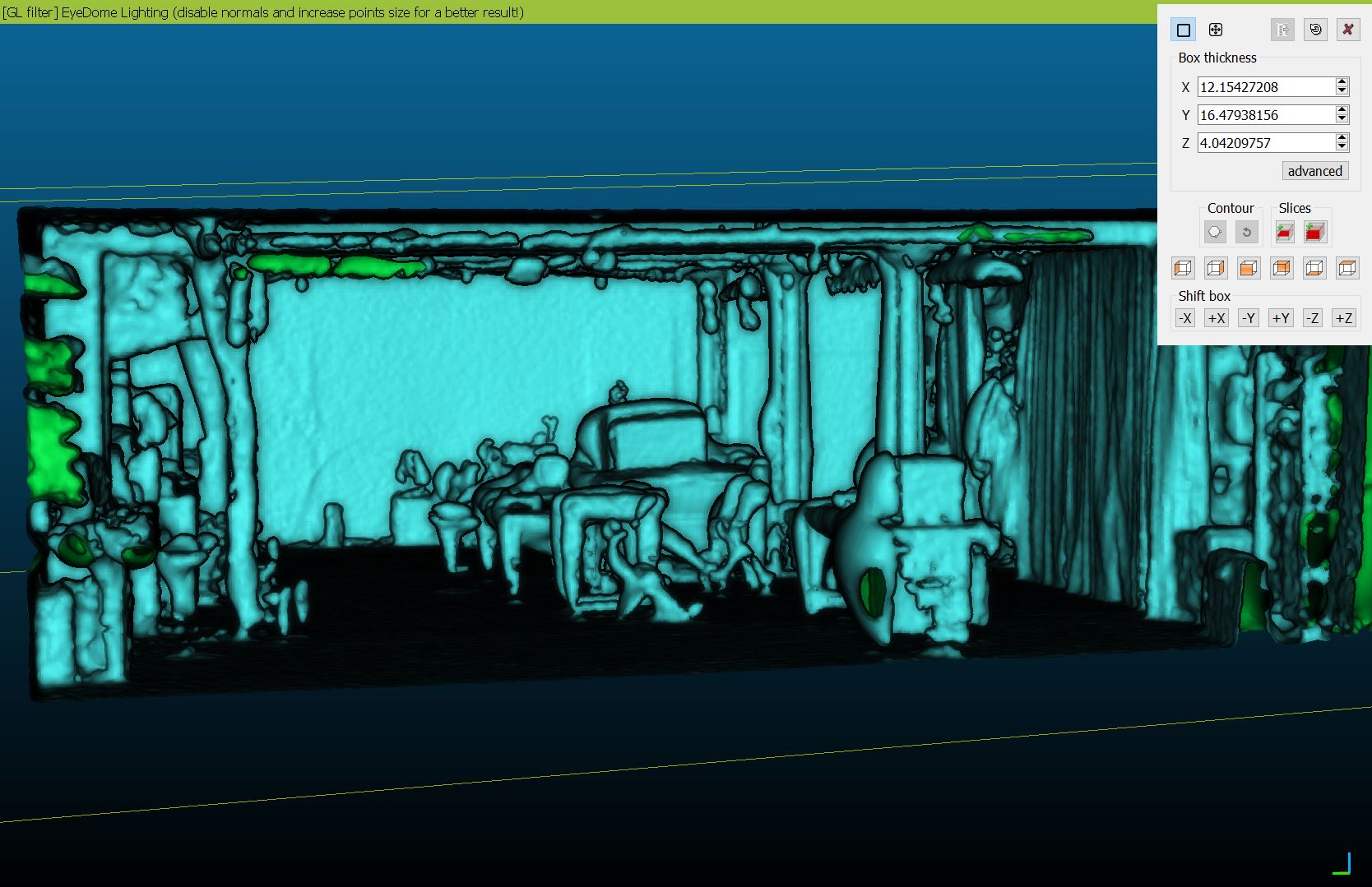

And here is what's inside (it's always the trickiest, especially since it's more noisy and it's hard to compute normals correctly)

Thank you daniel, much appreciated.
So it seems the scan in itself is too noisy, very dissapointing fo such an expensive device.
Re: Meshing an interior scan pointcloud
I would say it's good for big objects, walls, etc. And to extract global dimensions, trends,etc. But definitely not for small objects indeed.
