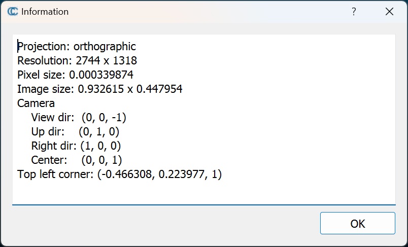

Re: Getting a real size location of the rendered image
So playing with this idea (but in a very simple way ;), I realized that there's no way we can determine the corner unless the camera looks straight (and in orthographic mode). Otherwise, the coordinate of the corner depends on the depth (along the camera direction, and along something more complication in perspective mode).
Anyway, I added a 'info' button on the 'Render to file' dialog, and also a 'Display > Current 3D view information' method, which will display various pieces of information (that you can copy-paste):
I'll let you play with that (with the latest 2.14.alpha release).

Hello again! I noticed that the last line of the info text (Top left corner: (###, ###, ###)) is missing in the new 2.14.beta. Is this intentional? Or am I missing some additional setting? This feature was very helpful to me.
You can only see if in orthographic projection (as with perspective projection, instead of a line aligned with the camera direction (+Z), it's an oblique line in 3D).
