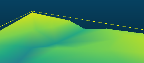

This is the DEM when no mesh display option is selected (let's say it's a "solid" mode) :

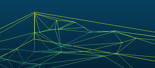

Here when the wireframe option is ticked :
(ticking wireframe + stippling together doesn't make any differences with the wireframe mode only)

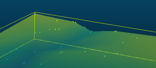

And here when the stippling option is enabled :
The white dots that you can see here are the triangle vertices.
But I wish I could also display the edges of the triangles in both the solid and stippling modes, for example in black or white (or any other user defined color), so that we can effectively see the borders of the triangles.
