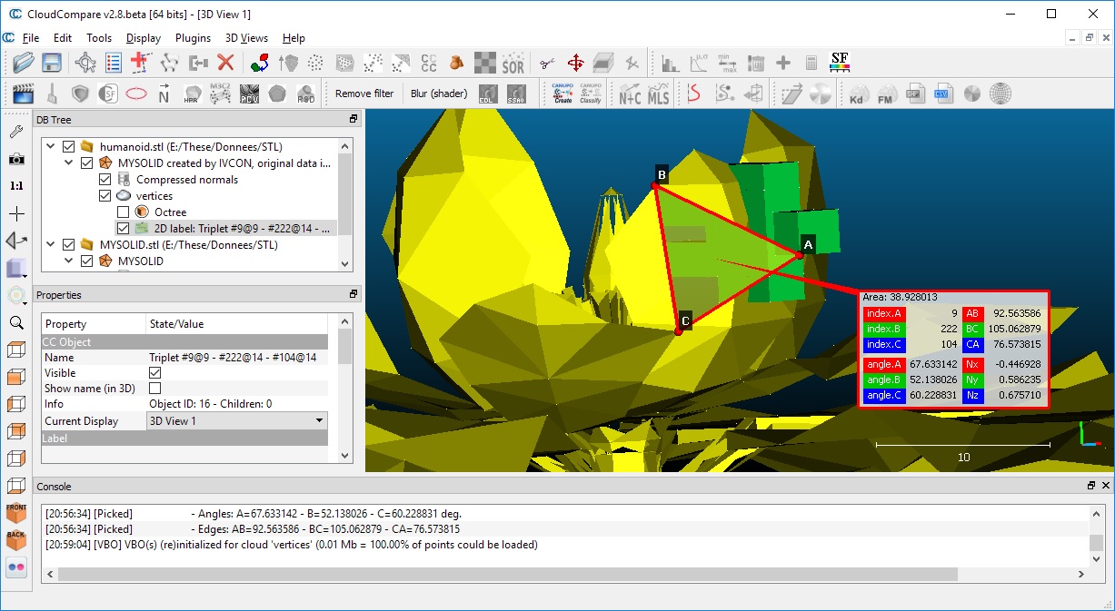

This issue has just re-occurred again (I thought it must have been me!), but its definitely present in a few of my currently open files.
A bit more info:
After creating a 2D label (angle measurement in my case) the label does not appear in the tree under its respective cloud.
The 2D label cannot be selected in the graphics window.
Exiting CC and reloading (after a save of course) it then DOES appear in the tree, but if selected in the tree it goes red in the graphics window - but it cannot be moved. It still cannot be selected in the graphics window.
I'm using 2.8 Beta. There are STL derived meshes in the file, a primitive and some saved viewports.

It's a single pointcloud and it doesn't seem to matter if the 2d label is angle or distance, it just will not select in the graphic window. I have just discovered that I have the same problem with the cross section interactors - I cant move those either - in both cases the if I click on the interactor or 2D label the cloud behind it moves as if if they were not there. Strange as the cross section tool is my most frequently used toy.
Im using the 2.8 beta 16/9/2016 with 3D spaceball, 2 x monitors, Dell M6700, Windows 10
