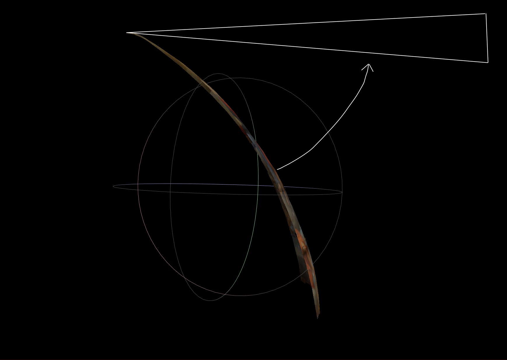

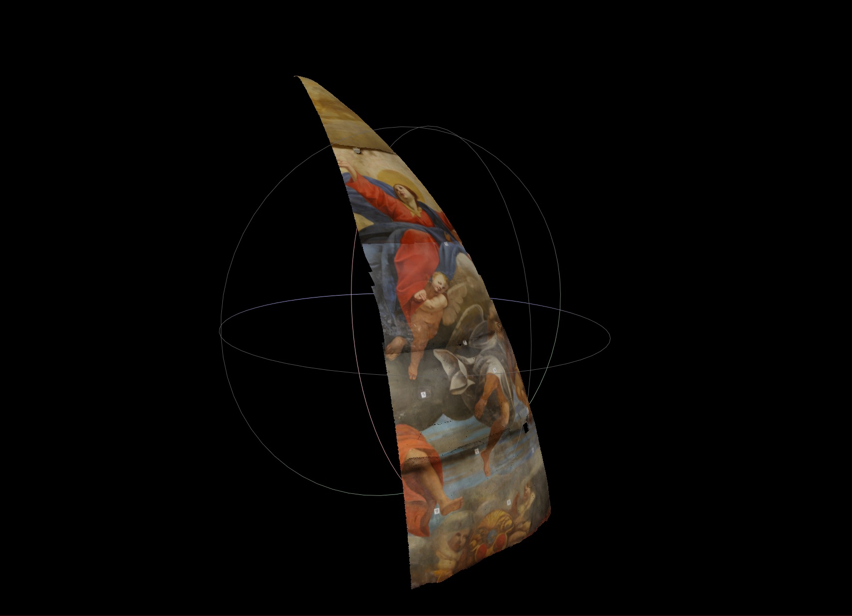

I have this part of a big model. On the mesh there is a textures. So, I need to elaborate a flat drawing for a restorer. Is it possible with cloud compare?
Yes, I know that it is a model with two direction of distortion and so will be distorted, but is there other solution?
Thank you
unroll Mesh with texture
- sviluppo_2.jpeg (94.07 KiB) Viewed 11027 times
- sviluppo_1.jpeg (116.55 KiB) Viewed 11027 times
Re: unroll Mesh with texture
Sadly it's not possible to do this kind of 'spherical' retro-projection with CloudCompare directly.
With CC you could:
And eventually you could load the projected cloud back to CC to generate a visual.
With CC you could:
- sample a lot of points on the textured mesh to get a dense point cloud (with colors)
- fit a sphere to determine the center and radius of the dome
- export the cloud as an ASCII file
