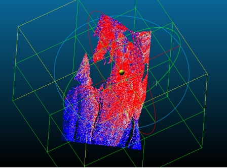

Hi guy
I'm a newbie of CC.
When I use CANUPO classification plugin to classify my point cloud derived from terrestrial-based LiDAR. This result shows below.
But I dont know how to delete special class or non-vegetation in CC except by manual with segmentation.
Thanks in advance.
Posts: 8192
Re: How to remove non-vegetation points
Simply use the 'Edit > Scalar fields > Filter by Value' method (http://www.cloudcompare.org/doc/wiki/in ... r_by_Value).
In this case you just have to use the class index you want to keep for both fields (min and max). This will create a new cloud with the corresponding points.
