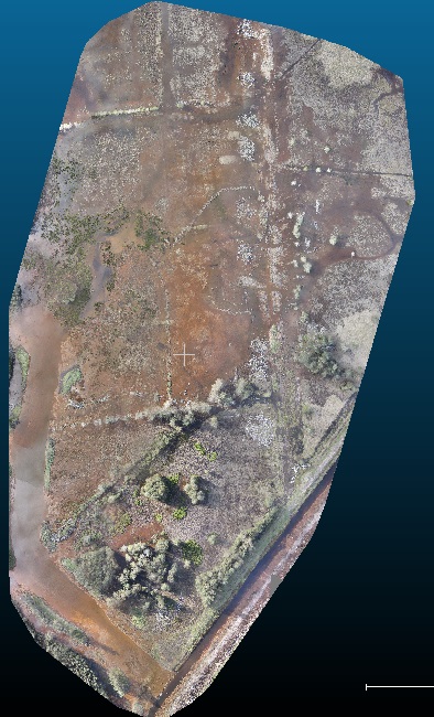

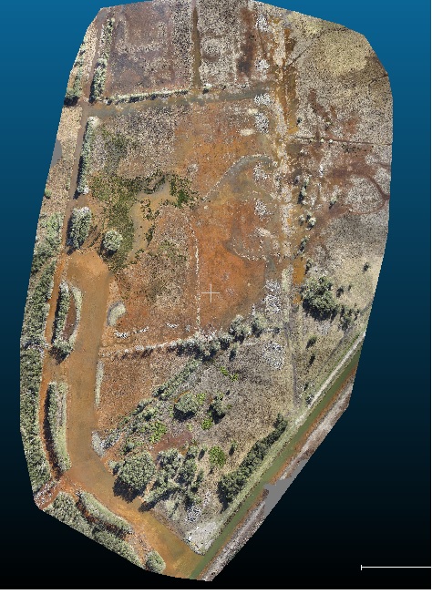

Thanks for the help so far. I’ve included some screenshots of the two point clouds, to make it clearer. The density of the two clouds is about 4cm/pixel. I guess I want to measure the smallest possible topographical change as possible, as the difference between the two water levels will be about 10-20cm. As you said I don’t think I can remove the vegetation in some areas, due to the density, or can I? If there is anything else you could add, it will be much appreciated.

- Low_Tide.jpg (119.7 KiB) Viewed 14245 times
- High_Tide.jpg (158.12 KiB) Viewed 14245 times

As Dimitri suggested, the qM3C2 algorithm with 'vertical normal' mode is clearly the best way to go. And if you manage to fully remove the vegetation with the qCanupo plugin on one of the clouds (it may be simpler on the lowest tide cloud), it should avoid making false detections in the qM3C2 process? qCanupo is really easy to use.
On a side note, I intend to develop soon a tool to compute distances and volume difference along a single direction. This tool would be based on the same principle than the 'Rasterization' tool (Tools > Projection > Rasterize). Would you be interested in beta-testing it? Or can you share your data with me? (you can send me an email to cloudcompare [at] danielgm.net if you're interested).
