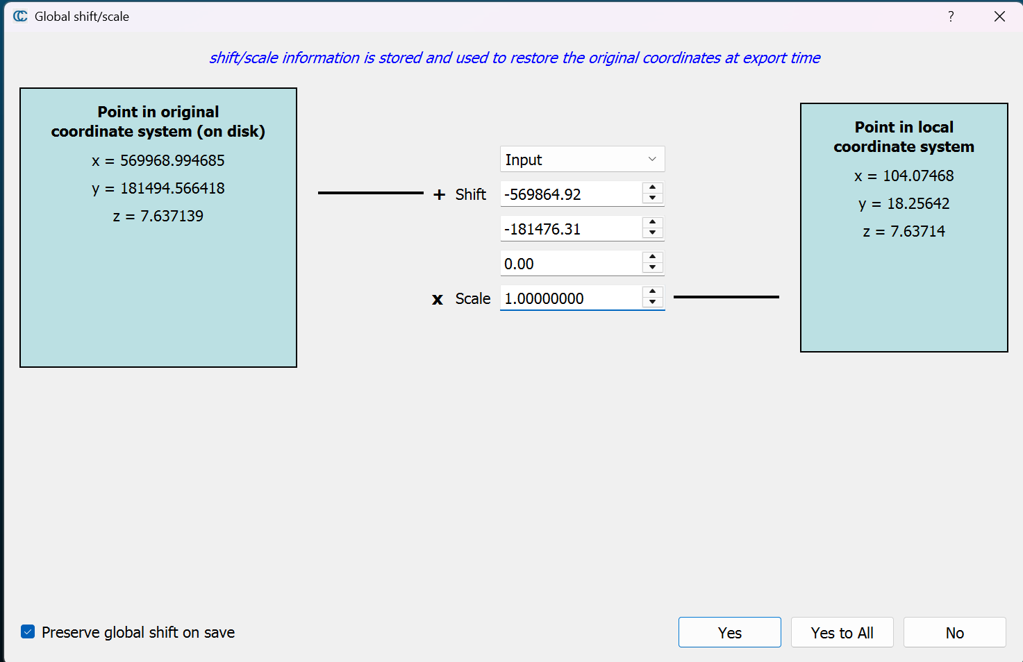

I’ve tried both clicking “Yes” and "No" to apply the global shift when initially loading into clouc compare, but I get the same result both ways.

Normally, you should (always) click 'YES' when asked to apply a Global Shift. That's mandatory to restore the original coordinates.
Then which version are you using? Normally, exported geotiff rasters should preserve the coordinates.

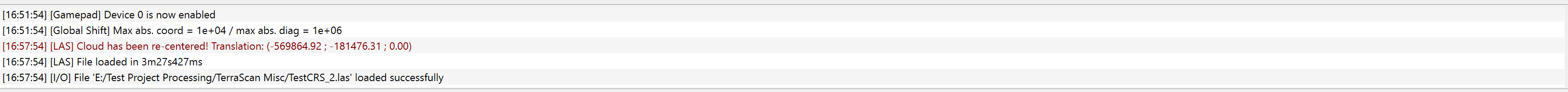

As I said, the CRS is mainteined in the output from reality capture, and it is recognised upon uploading to CC when asking to apply Global shift.
After doing this, I am also getting what appears to be an error message in the Console that suggests the coordinates have been reset to 0,0.
Im assuming this is the root of the issue but so far I have not been able to solve it.

Re: Rasterise Outputs arent maintaining the original CRS
No the warning is normal, it just to tell the user that all coordinates have been (temporarily) translated to local coordinates.
But this should normally be restored when exporting entities to most of the file formats supported by CC, and also to geotiff files.

Did you apply (and keep) the suggested Global Shift? And which output format have you chosen?
