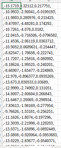

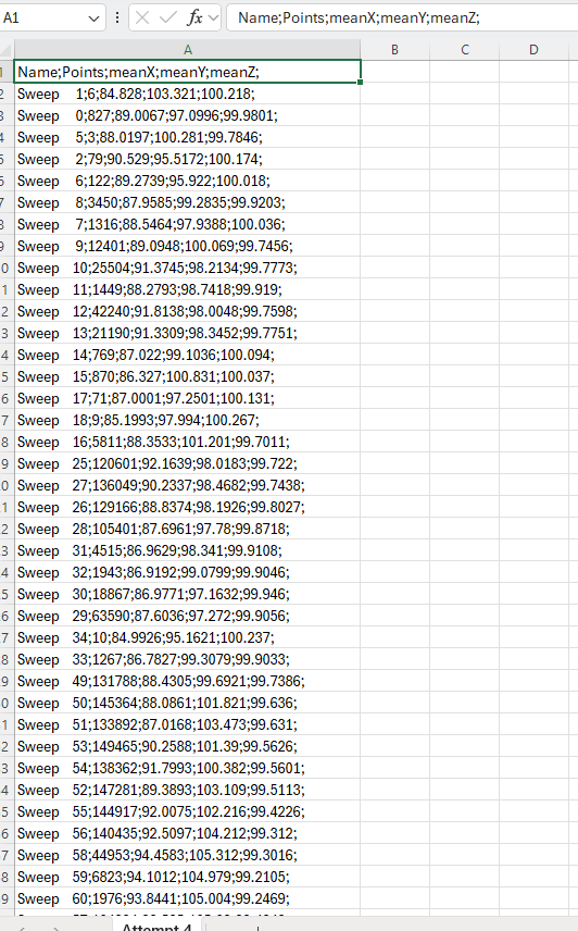

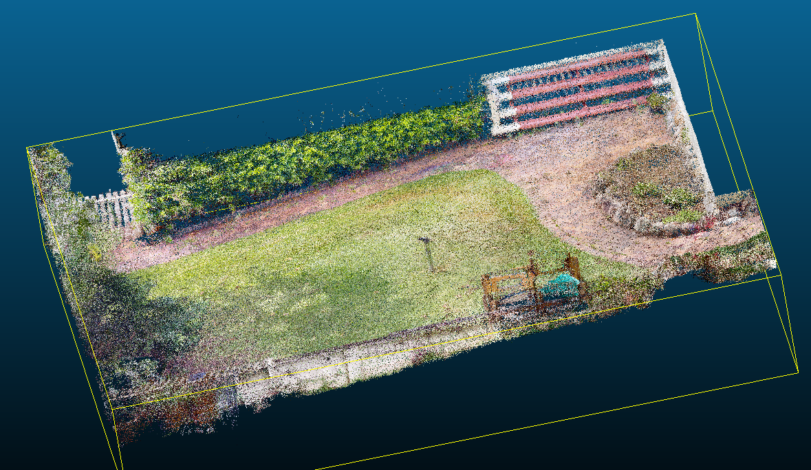

At this point I have been able to create a csv file which has imported to create a portion of the topo, but not the whole thing and not in a straightforward manner. The model imports into Cloudcompare well, but the export, has each sweep's name in front of each line, as well as using ';' as spacers which revit/australia doesn't allow. I went through the csv deleted the name e.g. "sweep 1 colour;intensity" so the lines are just x,y,z and replaced all the ';' with ',' and it mostly imported. but I have should have an approximate square of area and it only imported a trapezoid-ish area.
Basically I want the csv batch export to look like the "csv imported to revit" and include the entire area from CC not just a portion. so batch export to use ',' and to not include the sweep name nor the first 2 values

- View in CC.png (1.16 MiB) Viewed 30190 times

- CSV batch export.png (76.18 KiB) Viewed 30190 times
