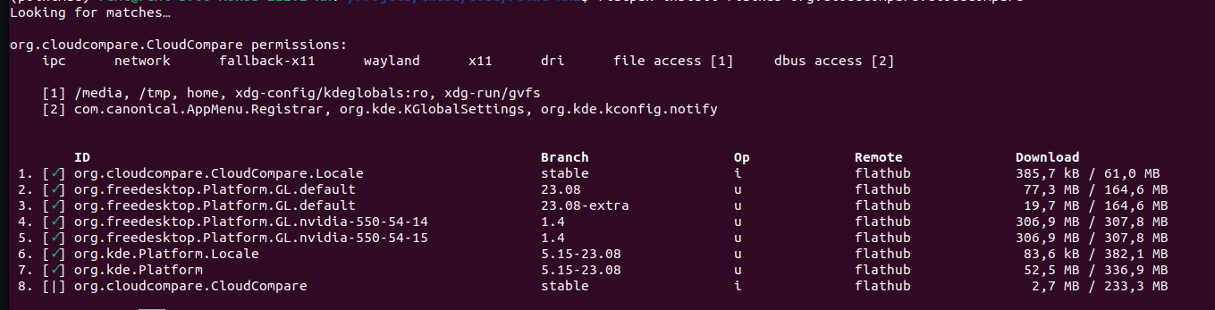

Here's my config:
Screenshot from 2024-04-12 11-17-11.png (84.69 KiB) Viewed 160415 times

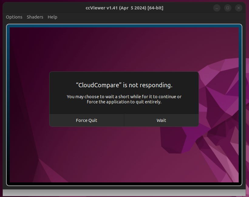

Everything is great during the installation, when i launch the software (Cloudcompare or CloudCompareViewer) and do nothing, it is working, but when i try to turn around on the 3d visualization, the viewer began to be black and then i have the pop-up 'Cloudcompare is not responding'

Solved by changing from Wayland to X11.
