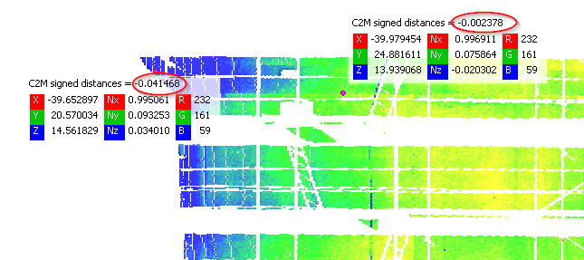

leble
Joined: Fri Oct 28, 2022 1:08 pm
Re: How to change the label color?
Post by leble »
Hello! I have a similar but maybe slightly different question. How to add a label but with only one item/description. In this case, I would like a label with only the value of the distance between the models. Because I don't need other data for the description, only the distance value.
distance value.png (79.86 KiB) Viewed 16710 times
Just right click on the label and it should 'collapse' (yes, that's kind of a hidden feature ;).
