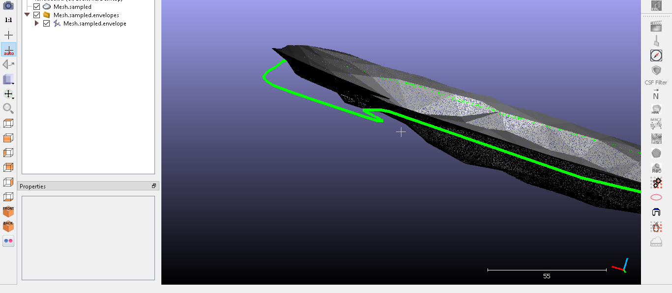

This helps a little but Z values of polyline does not match Z of perimeter of mesh?
XY are OK
The goal of extracting of mesh perimeter is to build with minimum manual intervention more realistic cover for mesh instead of close hole function in Blender and FreeCAD etc

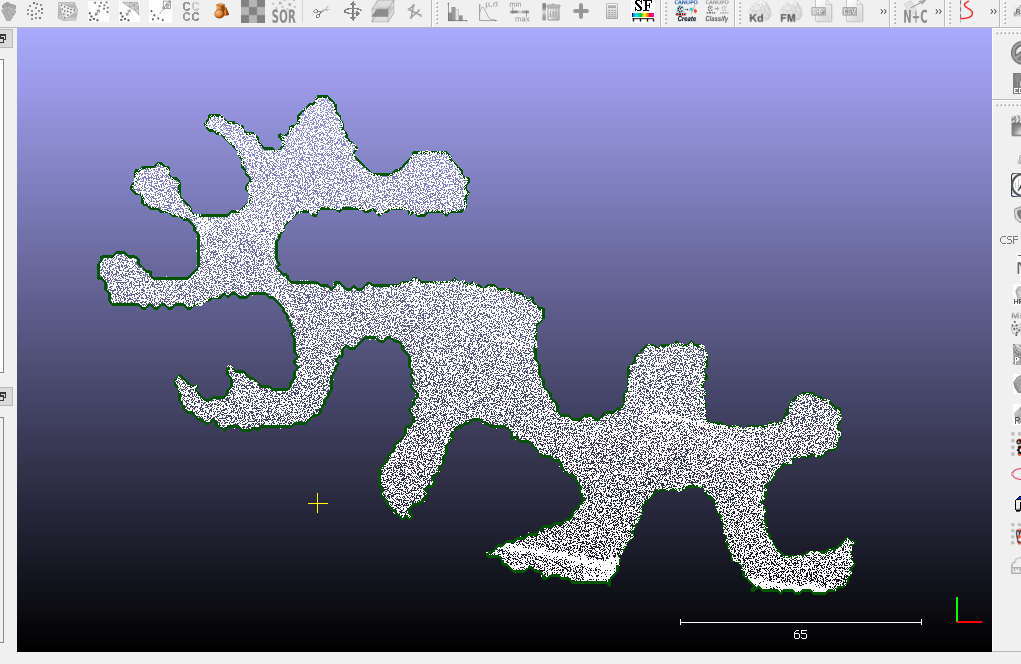

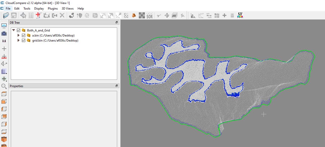

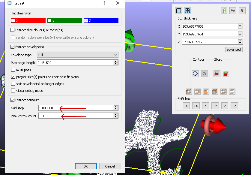

However, I found that polyline contour sometimes is not accurate in xy plane especially if there is big variation in mesh Z
see in image below
But playing with grid step & min. vertex count makes result polyline accurate in xy plane

I had good success following what I told you, zeroing out the Z value getting the contours then restoring the Z values. only extra step I didn't mention was to interpolate the original clouds SF values to the vertices of the extracted contours and restore the Z SF to the vertices as well to get the contours to follow up to the original locations.
a.zip
Your example file modified with the method described above
(538.52 KiB) Downloaded 2896 times
