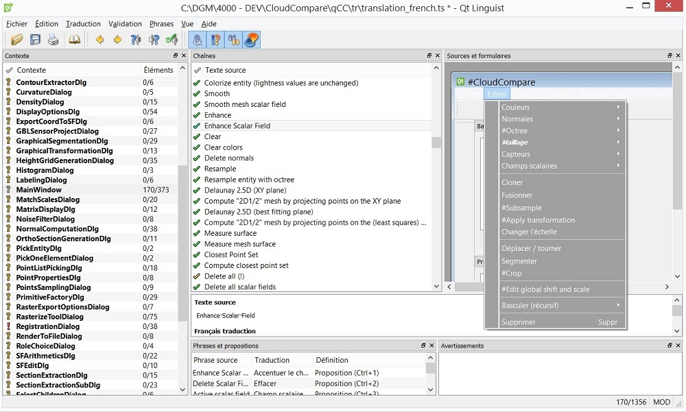

Translating
Translation is done with Qt Linguist (see the documentation here: http://doc.qt.io/qt-5/linguist-translators.html). Simply install the latest version of Qt to get it (you'll found linguist.exe in the 'bin' folder).
Then simply open the right '.ts' file in Qt Linguist and you can start the translation job!
Start by the 'MainWindow' component (this is the main GUI of CloudCompare). You can easily see how the work progresses (see below).
