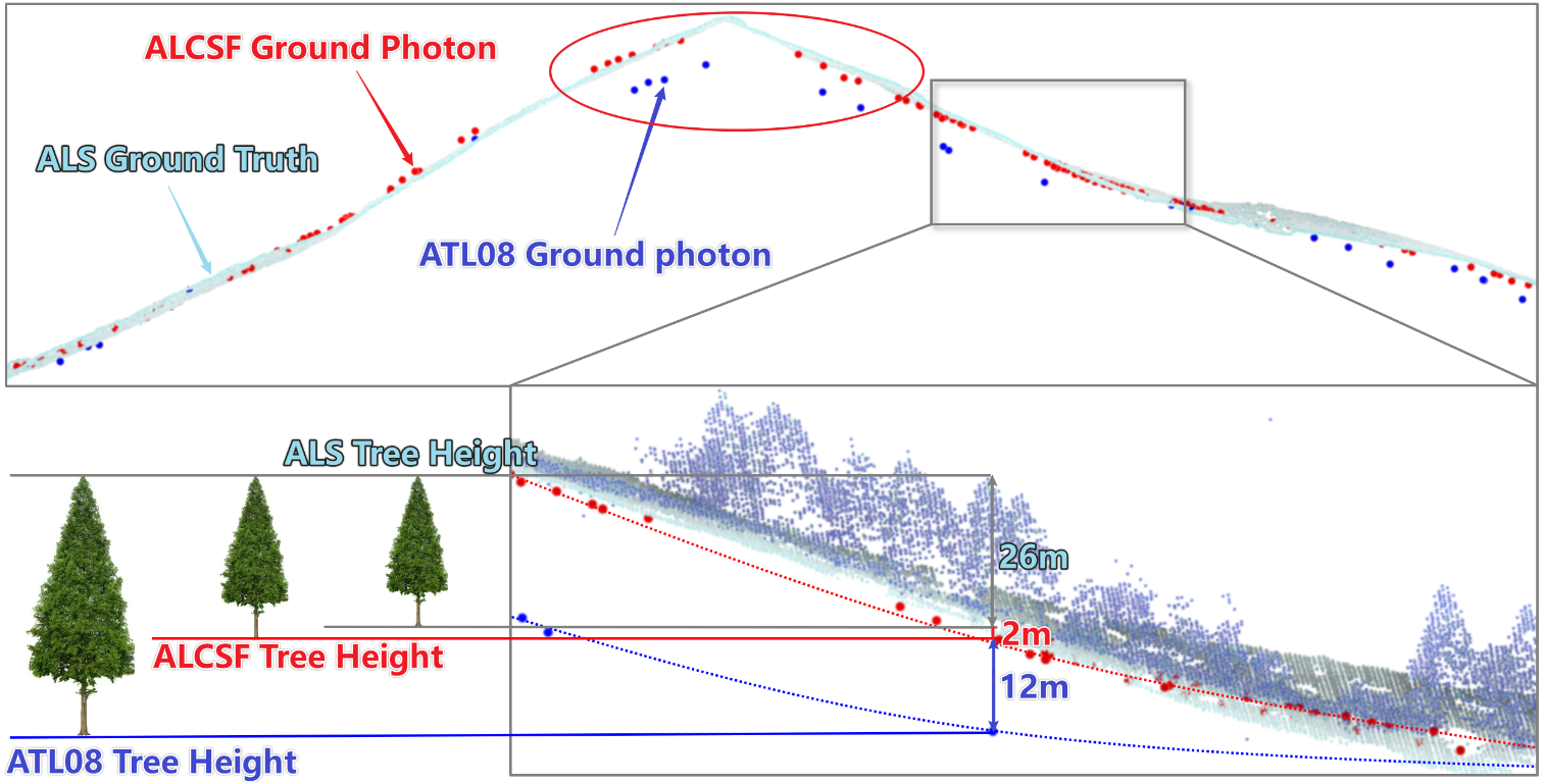

Hi, all. Recently, we published a paper which extends CSF to deal with the photon point cloud of ICESat-2 (LiDAR mounted on a Satellite). The result is more accurate than NASA ALT08 product.
Chang B, Xiong H, Li Y, et al. ALCSF: An adaptive and anti-noise filtering method for extracting ground and top of canopy from ICESat-2 LiDAR data along single tracks[J]. ISPRS Journal of Photogrammetry and Remote Sensing. 2024, 215: 80-98.
This paper can be downloaded for free before August 24th, 2024. Feedback and citations are welcome.
https://authors.elsevier.com/c/1jNW73I9x1qnnC

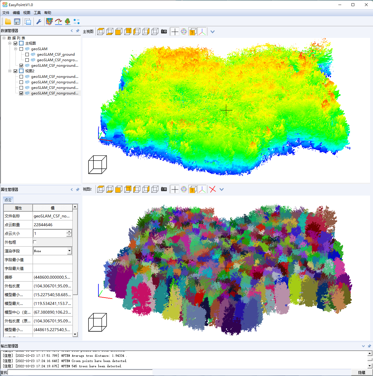

Re: Add ground filtering plugin (CSF) to the official repository of cloudcompare
Ok, I prefer to be sure, because this capture for instance is a little bit troubling:
- The icons to select the camera default orientation with a similar orange
- The 3D view, with the trihedron as 3 simple red, green and blue lines, the crosshair in the middle, etc.
Of course it's not a unique design, but it's disturbing to see a point cloud software that mimics CloudCompare too closely. The others we've encountered in the past have all been using CloudCompare's code. 4 projects have been detected already: 1 Japanese and 3 Chinese commercial products. Only 2 have fixed the license infrigement issue so far. See https://www.cloudcompare.org/release/notes/20240214/, at the end, for the 2 others. You'll understand that I'm on the lookout now.
In a way it means that CloudCompare is a reference now ...
