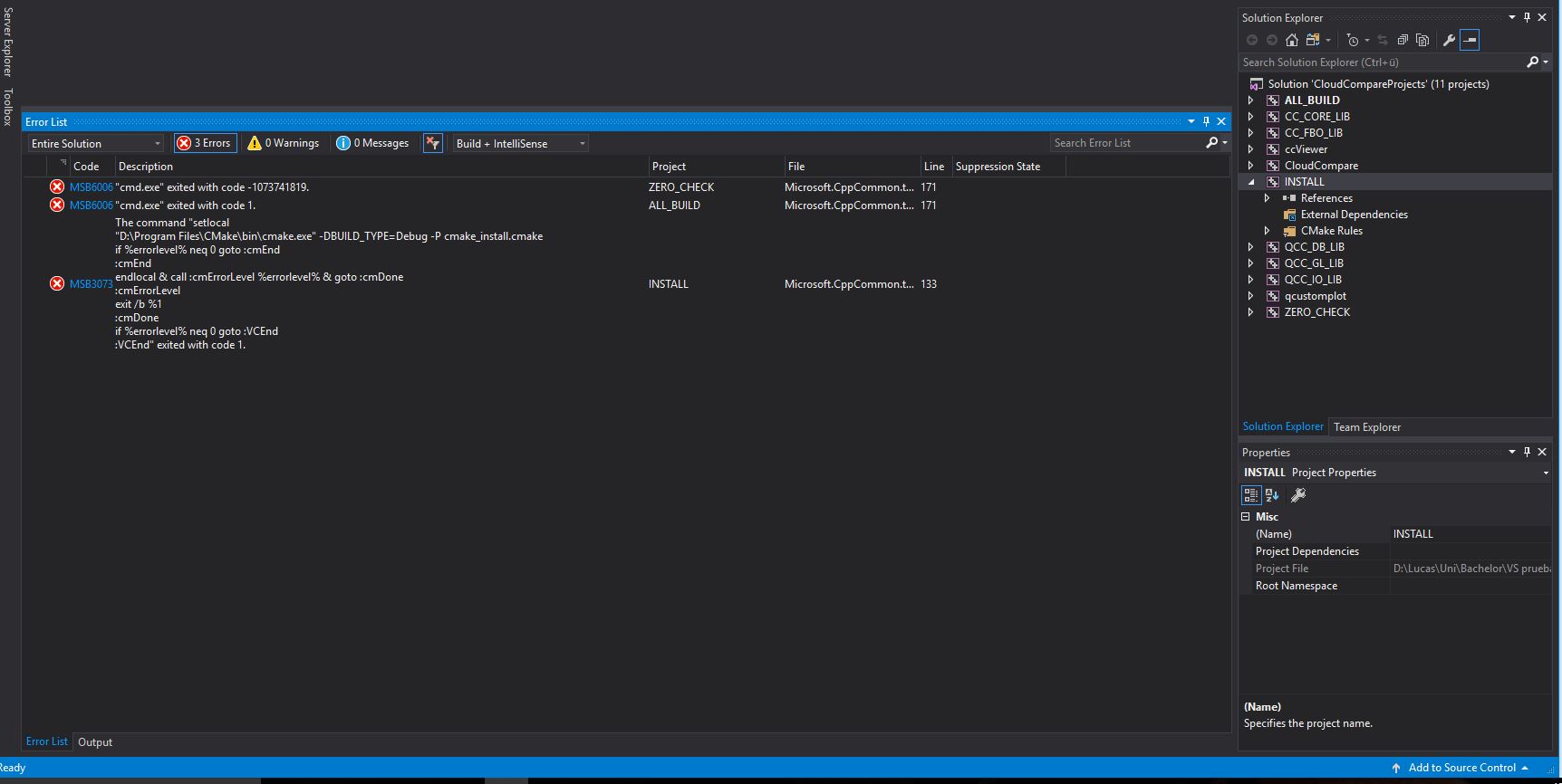

Thank you very much, that solved the problem. But now, as I try to compile the INSTALL project, I get 3 errors...
What I need to do is get a mesh of a point cloud. I got it using the Delaunay feature in CloudCompare and now I have to automate it, so I thought it would be easy to program it in C++ using a library but I'm completely lost and overtaken. I have never done anything similar (I learned to program in C# but never used many libraries). Could you point me in the right direction or tell me if what I'm trying to do is achievable?
I attached a screenshot of the errors. Thank you very much again.
Re: CMake Errors
Why don't you use the command line version then? (http://www.cloudcompare.org/doc/wiki/in ... _line_mode)
Otherwise regarding your compilation issue, have you set the 'install' directory to a path different from 'Program Files'? (refer to the compilation instructions).
