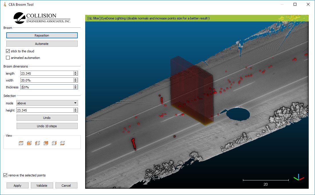

The virtual broom (yellow) automatically sticks to the cloud. You can change its dimensions thanks to the 'broom dimensions' parameters (on the left):
  • length: the distance between the two picked points by default. Can be changed afterward. Warning: the longer the broom will be, the slower the tool might be, and the more issues you might have if the surface is curved. To clean a road for instance, the width of one or two car lines should be sufficient.
  • width: the width of the broom. 20% of the length by default. If the width is too small, the plugin might no be able to stick to the surface correctly (especially in case of a noisy surface)
  • thickness: the thickness of the broom. This is mainly used by the plugin to stick to the surface. In the default mode (cleaning), the points falling inside the broom won't be deleted. Therefore it is good to make the broom as thin as possible. However, especially for noisy or curved surfaces, the plugin won't be able to stick the broom to the surface correctly if the broom is too thin... It is sometimes a good idea to use two different brooms (first, a thick broom with a high selection volume, and then a much thinner broom with a low selection volume).
The second important set of settings concern the selection volume (red):
  • mode: you can delete (or 'select') the points above / below / above and below / or inside the broom box itself.
  • height: the height of the selection volume. This volume has the same horizontal extents as the broom box, but if the selection volume is not 'inside', its height can be modified as the user prefers (to catch all the noise, or on the contrary to avoid catching points above a given altitude). Of course the bigger the selection volume will be, the slower the tool might be.

By default, the user is supposed to manually 'sweep' the broom. Left click on the broom, keep the mouse button pressed, and then move the broom. The broom should stick to the surface, and the points falling inside the selection volume will be colored in red by default. Now all you need is time, as with a real broom ;)
Note: the 'stick to the cloud' checkbox allows you to enabled or disable the automatic broom 'sticking'. Disabling it might be a little tricky ;

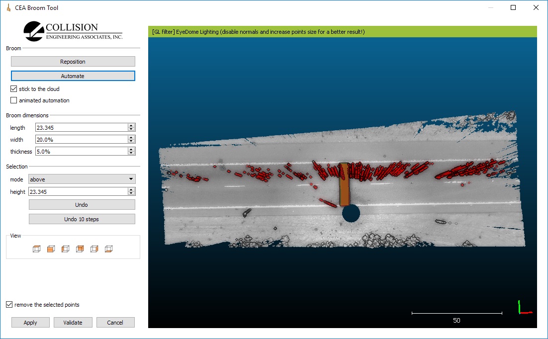

For simple surfaces such as roads, it is possible to automate the process by drawing a rectangle over the surface in which the broom will be automatically 'swept'. Look at the surface from above, change the zoom so as to see the whole area to clean, and click on the automate button. The plugin will ask you to pick two corners of the (rectangular) area to be cleaned. Actually these are two corners on the same side of the rectangle. Then you'll be able to change the width of the rectangle interactively by moving the mouse, and you can fix it by clicking a last time on the left mouse button. Once defined, the plugin will automatically sweep the broom inside the defined area.
