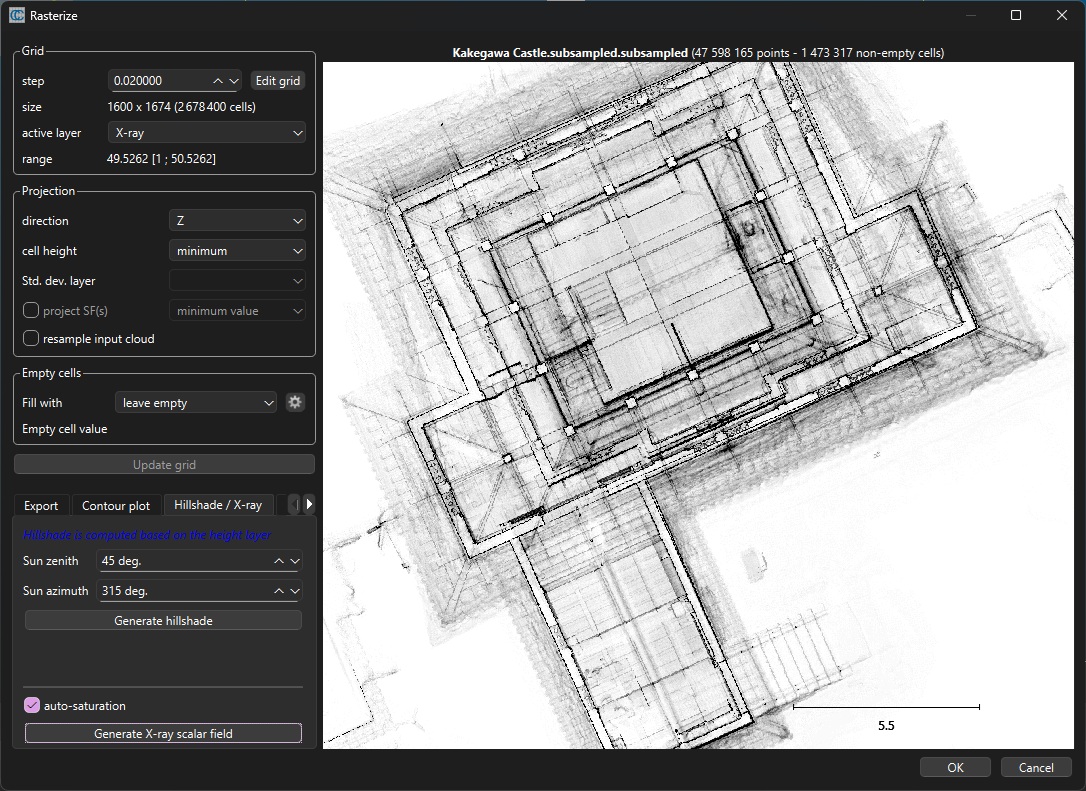

Hillshade / X-ray
Since version 2.6.3, the Rasterize tool can generate an hillshade layer:
Once the grid has been generated:
  • click on the 'Hillshade / X-ray' tab
  • set the right parameters (sun position)
  • click on 'Generate hillshade'
Since version 2.14, the Rasterize tool can generate an X-ray layer, with a very similar process:
  • click on 'Generate X-ray scalar field'
Note that these layers will disappear each time the 'Update grid' button is clicked
