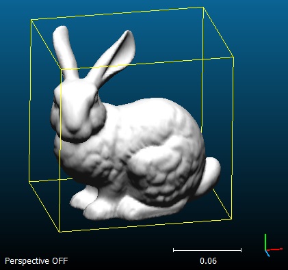

Orthographic view
This is the default viewing mode. It is a parallel projection (i.e. parallel lines never cross).
See http://en.wikipedia.org/wiki/Orthographic_projection for a bit of theory.
Note: in this mode, a white scale is displayed (in the bottom right corner of the 3D view). Its actual dimension in the current coordinate system is displayed below.

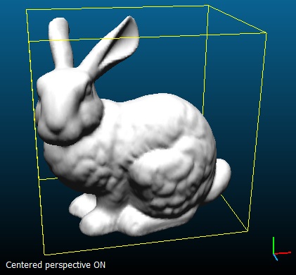

Object-centered
In the 'object-centered perspective' mode, the object rotates when the user moves the mouse while pressing the left button (the camera orientation is fixed). Using the mouse wheel will make the object farther or nearer from the current point of view.
Note: this mode can be toggled with the 'F3' shortcut.

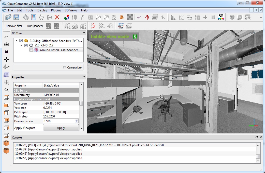

Bubble-view (polar)
This viewing mode can be (properly) enabled via a 'GBL/TLS sensor' entity or a cloud associated to such a sensor. They are generally structured point clouds (PTX, FARO, etc.).
To enable this mode:
  • highlight the sensor entity in the DB tree and click on the 'Apply' button in its properties (Viewport section)
  • or press the B shortcut if a sensor or an entity associated to a sensor object is highlighted
While in this mode, the camera position is fixed (normally at the sensor center) and the user can only rotate it (with the left mouse button) or change the zoom (with the mouse wheel).
Note: in fact the zoom is simply obtained by modifying the camera field of view (f.o.v.). Therefore high optical distortion can occur after a certain point.
FARO scan viewed in polar 'bubble-view' mode
To leave this mode the user must click on the icon in the top left corner of the 3D view.

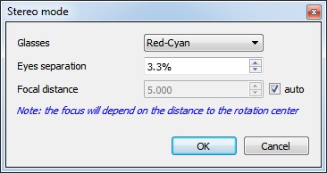

Stereo mode
To activate one of the stereo modes, the user must click on the icon in the left '3D view' toolbar. The following dialog will appear:
Simply click on the same icon again to deactivate this mode.

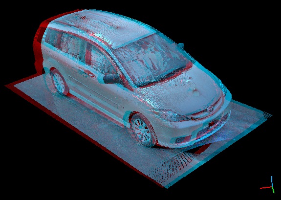

Anaglyph
Since version 2.6.2, CloudCompare has a new 'stereoscopic' display mode.
This display mode should be used while wearing (cardboard) red and blue or red and cyan glasses.
The user must choose the right type of glasses (red/blue or red/cyan, and blue/red or cyan/red since version 2.7) as well as the eye separation ratio. Increasing this ratio will increase the stereo effect... but this can also cause an unnatural feeling and headaches ;). One can also choose to use a dynamic focal distance (so as to always focus on the current rotation center whatever the camera position) or a fixed focal distance (typically if you need to focus on a particular point in the scene - however moving around with a fixed focal might also be very strange and give you headaches ;).

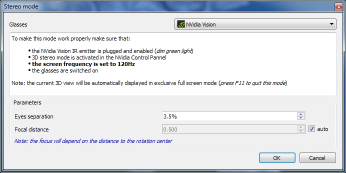

NVidia 3D Vision
On Windows, since version 2.6.3 (and 2.7 'stereo') the NVidia 3D Vision glasses are supported.
To use it the user needs the proper equipment (i.e. a high frequency screen) and follow the indications that appear in the dialog:
CloudCompare will automatically enter in 'exclusive full screen' mode (so as to actually trigger the screen flickering and the proper activation of the stereo mode by the driver). If this mode is left the stereo mode will be automatically disabled.
