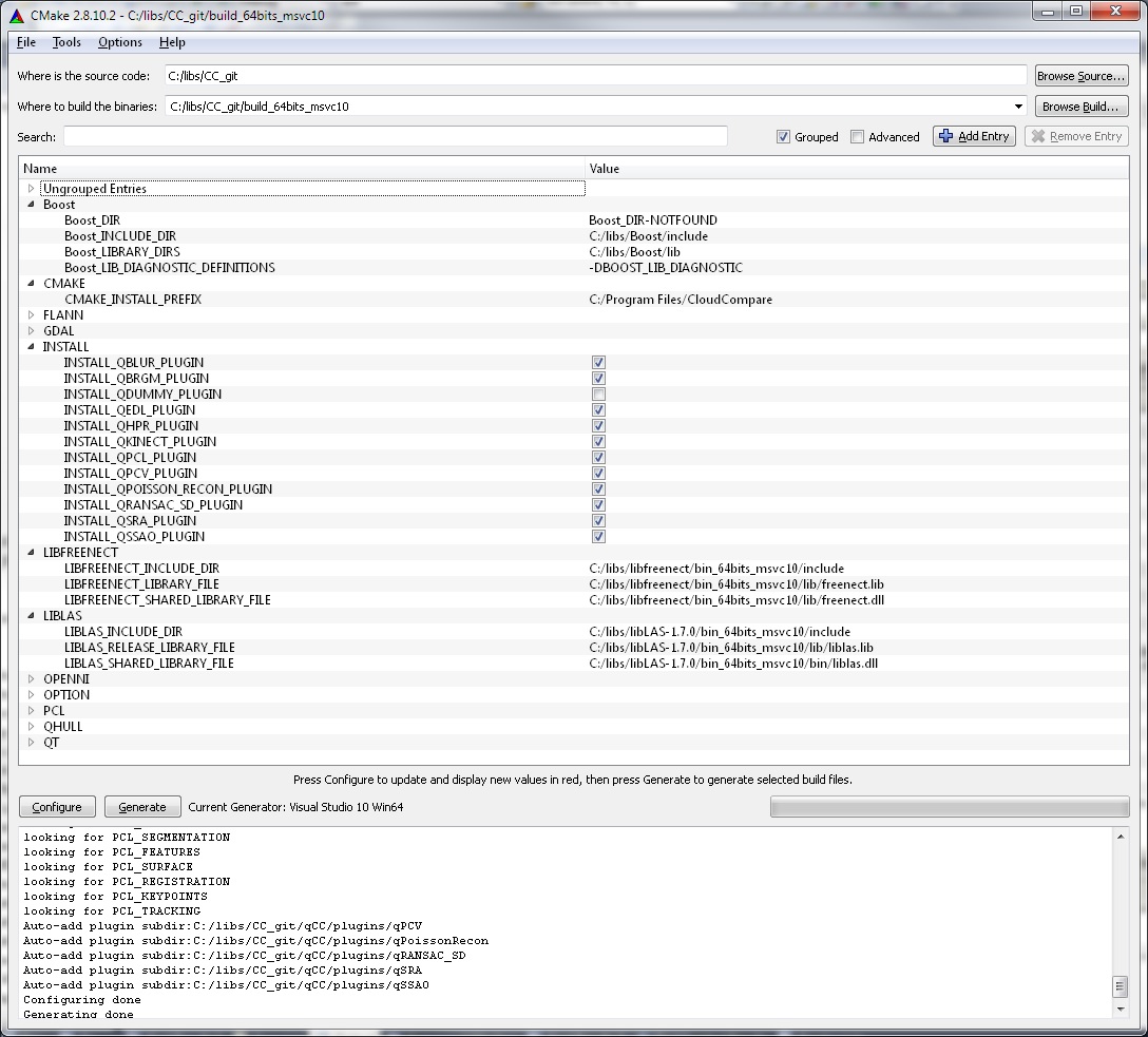

Generating the project
  1. Launch CMake GUI ('cmake-qt-gui' on linux)
    1. (for more convenience, you should check the "Grouped" check-box)
    2. make the Where is the source code field point to your local repository (for instance C:\trunk_CC).
    3. make the Where to build the binaries field point to ... almost anywhere you want (apart from the same folder as above!). For instance: C:\trunk_CC\build.
    4. click on the "Configure" button
    5. select your generator [already tested: Visual 2008 (32/64 bits), Visual 2010 Express (32/64 bits - see appendix), Visual 2012 Express (64 bits/Qt 5), Code::Blocks (Linux & Windows 32 bits), gcc (Linux 32/64 bits, Mac OS X)]
    6. Wait for CMake configuration/tests to finish...
    7. ...and you should see something like this:
Before clicking on the 'Generate' button, you may want to set some options:
