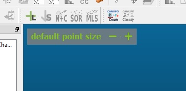

Well, first you can hover the mouse in the top-left area of the 3D view: you'll see a 'default point size + -' message appear. You can click on the '+' and '-' parts to make all the points displayed in the view bigger or smaller.

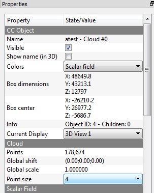

Otherwise you can set the ''Point size' property of a single cloud (you'll have to select the cloud to enable its properties dialog).

Thanks, that did it!
