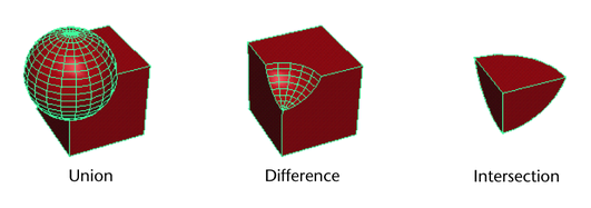

Hello !
Would it be possible to add some boolean operations (Union, Difference, Intersection) with meshes.
Thanks :)
boolean
boolean
