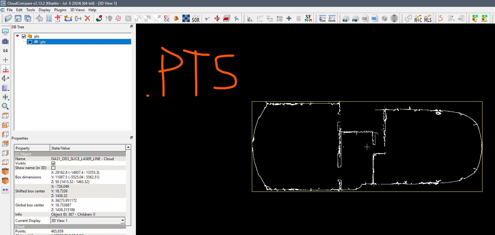

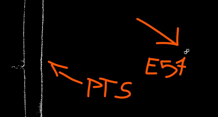

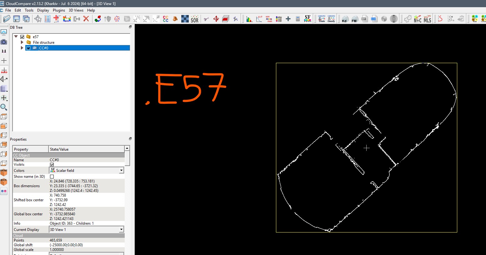

I have a small slice taken out from a bigger point cloud ("X" tool) -nothing strange or exotic-
exporting ("SAVE") the object in .e57 AND .pts results in a different placement once the two files are opened again (regardless the SW used to open it. even Cloudcompare itself shows this behaviour, hence, the issue IS in the data)
i'll attach 2 images showing that.
The PTS position IS the correct one.
Having scalar fields, having global shifts and/or normals or other "extra" data does not affect this.
.pts is created with only the x,y,z values, comma separated. Values are in millimeters. here's a line:
37401.24218750,-4620.99169922,1456.31518555
Exporting different formats results in different coordinates
- pts.jpg (143.51 KiB) Viewed 132353 times
- e57.jpg (150.53 KiB) Viewed 132353 times

Done, no luck.
The .e57 is not aligned and it is also scaled down by 0.001.
Since .e57 is in binary format it is not possible for me to check where the scale is applied, either in the file's data or at import time
- ptsptspts.jpg (26.6 KiB) Viewed 132341 times

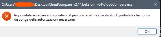

Ah! Again this error!
I think there's something CC "remembers" at .7z package creation (maybe the recents files list)
since i work onto a corporate notebook with limited permissions, if CC fires up trying to "probe" some paths i don't have permission to look into, i find myself in this deadlock situation
please note: the previous 2.14 .7z runs OK. I had this issue months ago, then it disappeared, and showed once again now

Re: Exporting different formats results in different coordinates
Can you try after moving it to something like C:/Temp ?
