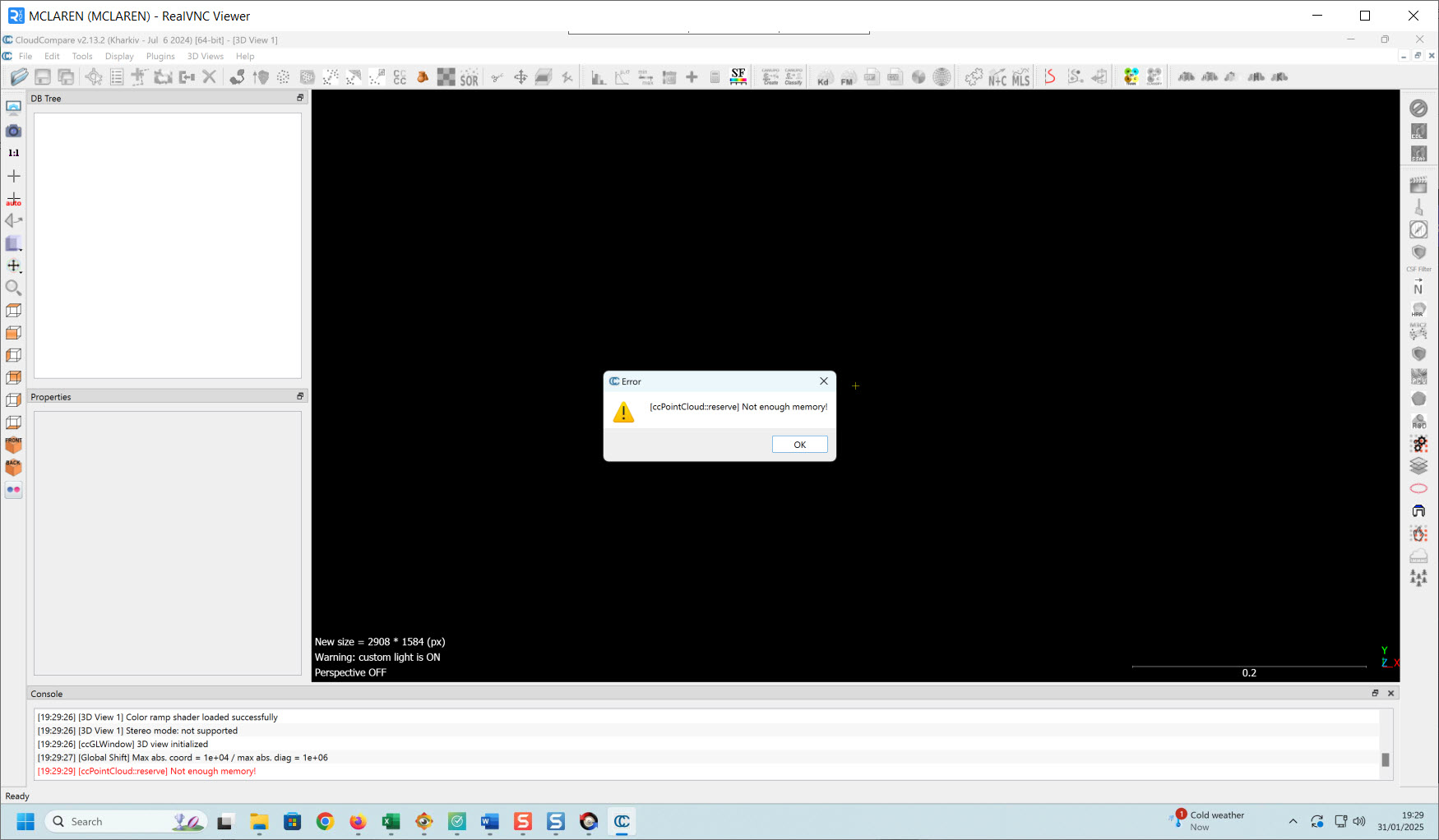

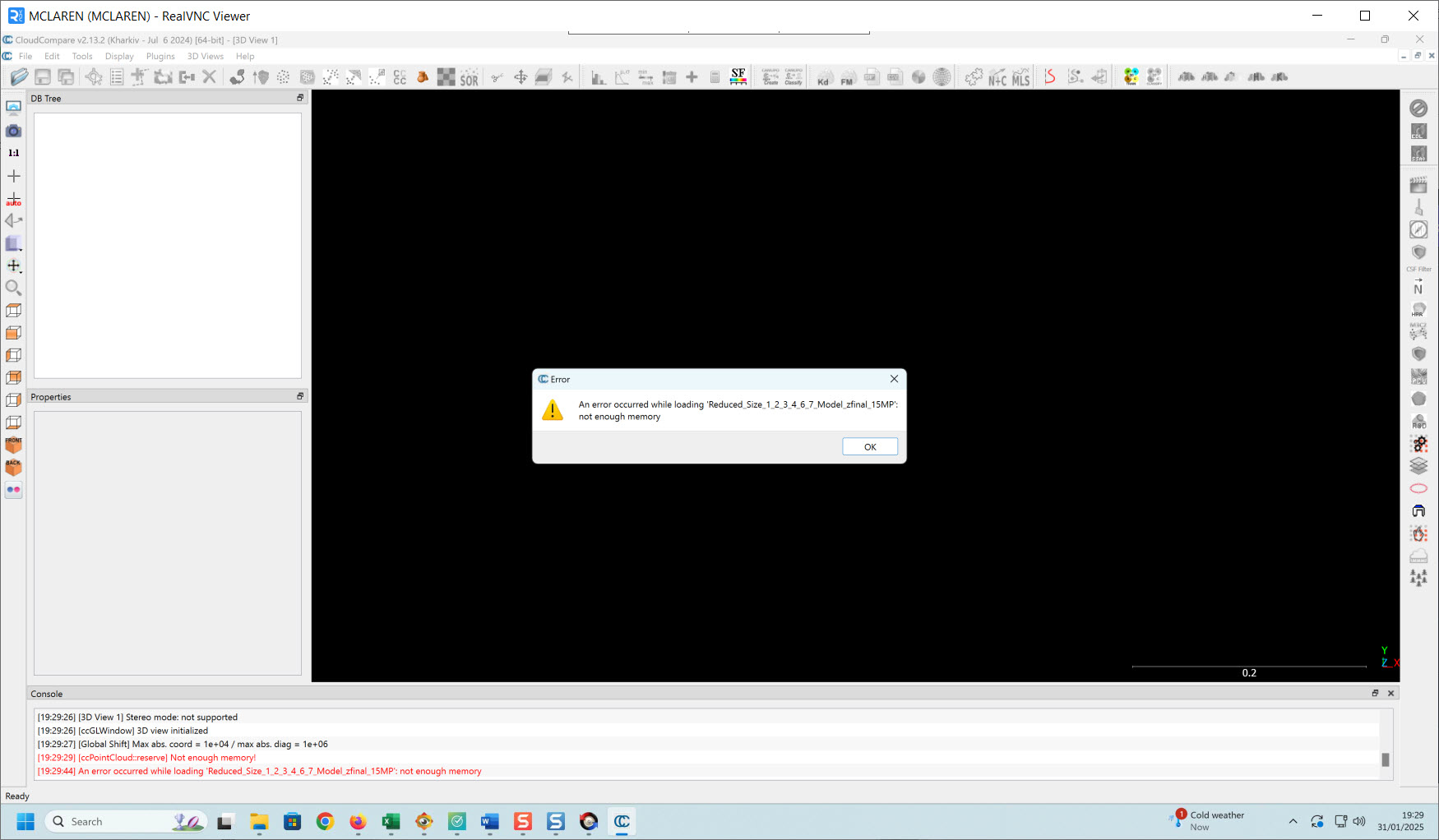

I have run into an issue opening a large .LAS pointcloud.
After "Oking" the first two boxes i get the first warning:
And then the second one:
I am unsure as to the reason. This is the latest stable release (2.13.2 Kharkiv (7/08/2024)), and the machein has 128Gb of RAM.
All the best,
Chris
Re: Issue opening .LAS
Well, I guess either the cloud/file is massive, or it's corrupted and CloudCompare tries to create a cloud with a ridiculously big number of points...
You could try to use the latest 2.14.alpha version in case it fixes something, but I doubt it will change something sadly.
