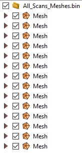

Concerning the import of multiple meshes
I have a folder with multiple meshes (.ply files) and use a command line script to regroup them into one single .bin file. The .ply files have all different names, but once regrouped into a single .bin file, all meshes are simply called "Mesh" with no other way to distinguish them in the DB Tree.
Is it possible to import the meshes while keeping the filenames referenced?

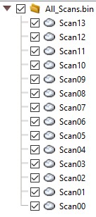

Concerning the export of multiple .asc files
I use the command line to open a .bin file with multiple clouds and export them one by one as .asc files.
The original .bin file has following DB Tree structure
To export the files, I provide filenames, creating a list of names.

This successfully creates following files
If no filenames are provided, the export does not reference the individual cloud name, but only the .bin filename followed by the numerical suffix.
Is it possible, instead of having to create an exhaustive list of names, to have the name of the specific cloud (eg. Scan13) used as name for the exported file?
