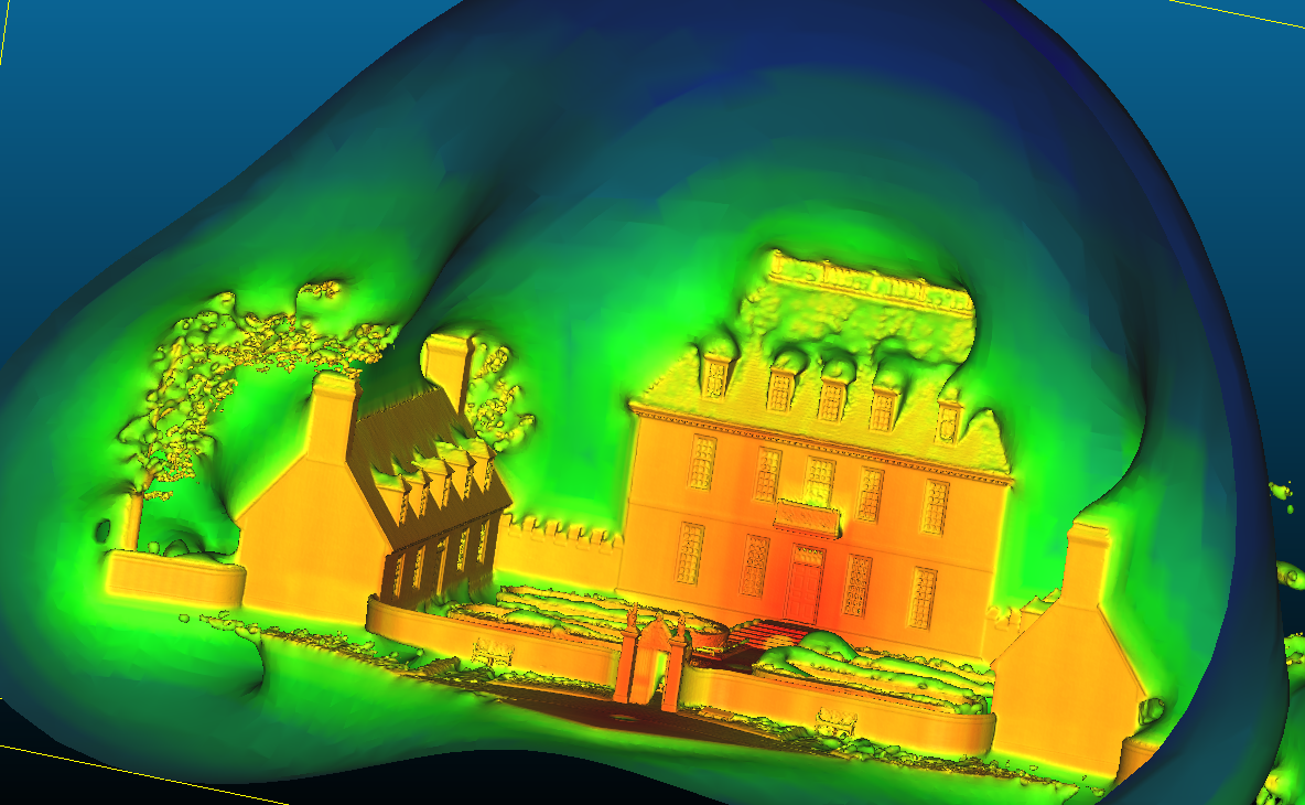

Hey guys, CC is great, I'm trying to clear this blob, do you know how?
I have a pointcloud in PST
I'd like to remove this blob
Screenshot 2024-07-08 152612.png (892.93 KiB) Viewed 4670 times

You can look for 'density' and 'Poisson' on this forum, or look at the documentation here: https://www.cloudcompare.org/doc/wiki/i ... n_(plugin) (see the 'Using the output density' section)
