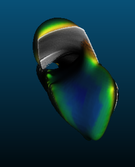

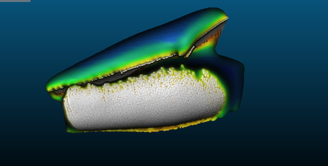

Hey guys,
Guys, I have this point cloud (see image 1) with these holes and I want to create a mesh of it.
So when I create a mesh, cloudcompare fills these holes automatically(see image 2) and I don't want that, and I wanted to know if anyone here knows how to solve this problem.
Thank you.

I guess you should activate the 'Density' output?
See https://www.cloudcompare.org/doc/wiki/i ... n_(plugin), last section.

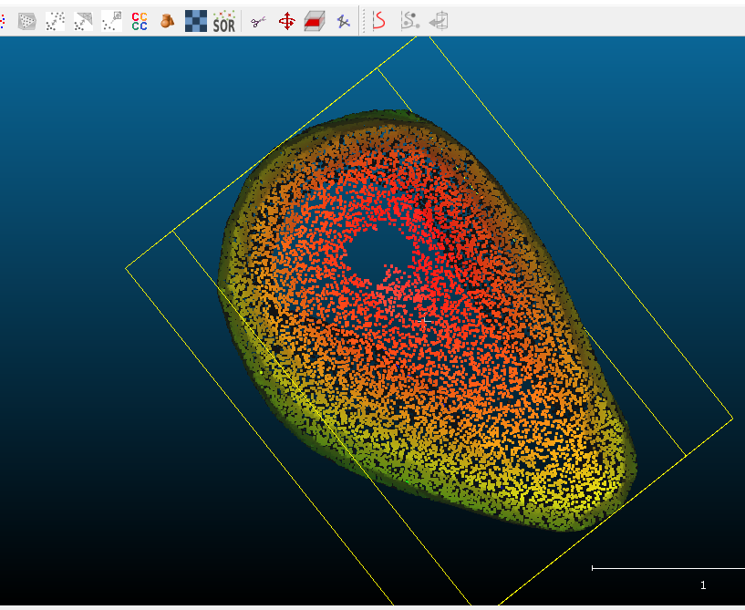

Gregnew wrote: Wed Jun 26, 2024 1:05 pm To prevent CloudCompare from filling holes automatically when creating a mesh from a point cloud, you typically need to adjust the parameters or settings in the mesh generation process
I attached here pointscloud example with a small hole in its top, I can not adjust the parameters to generate a real shape mesh with a small hole in the top.
Any idea just to investigate the PoissonRecon limit

Re: 3D reconstruction
Yes, PoissonRecon density is based on the proximity between the original points and the reconstructed nodes...
That's a bit clunky, but you could maybe sample points on the total reconstructed mesh. Then segment the hole part (point cloud subest) and add it to your original cloud. And re-mesh again!
