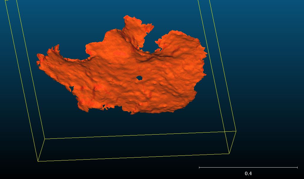

I want to find the surface area of the sponge. Basically, the area of the top of the 'rug' (not top and bottom). I tried turning it into a mesh with PoissonRecon, which got me a mesh like this:

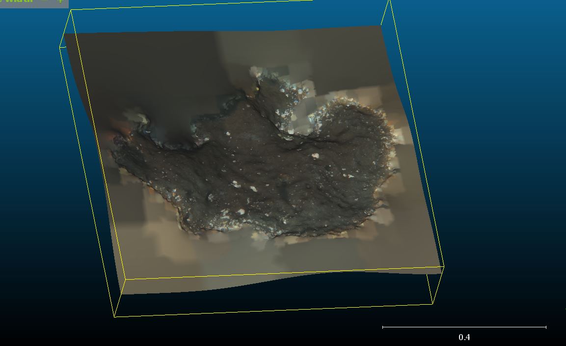

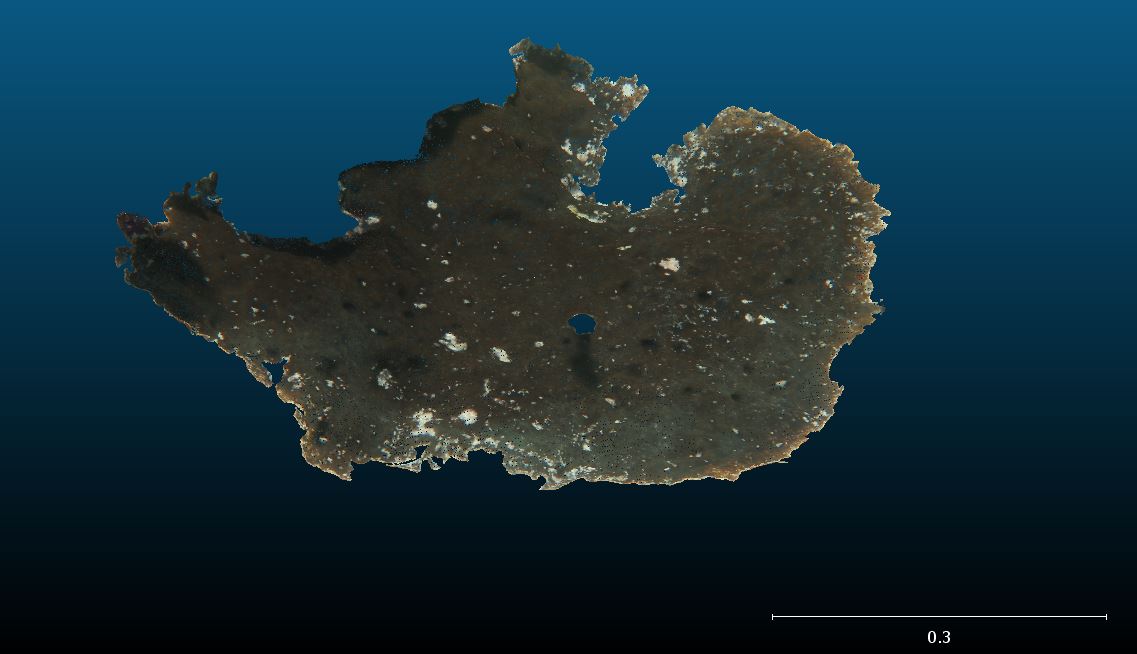

I changed the 'color' to 'scalar field' and then played with the display ranges to get me this, which was pretty much exactly what I wanted - it's a fantastic estimation of the sponge's surface and area:
And then I went into Edit -> Mesh -> Measure surface to get my surface area. Of course, I now realize that I don't think I was given the actual surface area of the sponge, instead I got the surface of the yellow box, which the original mesh entirely filled up.
Is there any way I can get the surface area calculation I'm looking for?
Re: Calculating Surface Areas of Open Mesh
So after playing with the 'displayed' scalar field range, you should 'Edit > Scalar fields > Filter by value'. This will extract only the visible triangles to a new mesh entity.
Then you can compute the surface of this new mesh.
