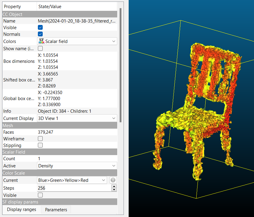

So I took this sample scan I was provided and used Segment to trip it down to just the chair & created Normals.
I then created the mesh.
Screenshot 2024-01-22 101748.png (184.58 KiB) Viewed 5656 times
The mesh is not defined at all and certainly not suitable to creating a model. I have changed a few settings trying to hit a sweet spot with no luck.

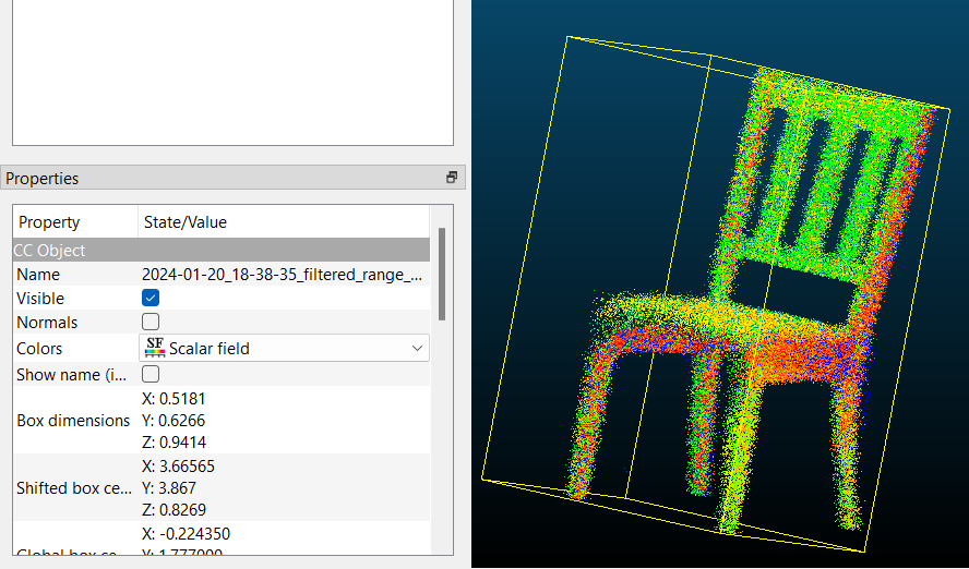

Screenshot 2024-01-22 102912.png (225.74 KiB) Viewed 5656 times
Re: Newbe creating mesh
So my main comment would be that your cloud is really noisy, and computing reliable normals on it is definitely a big challenge.
You say it's a 'scan'. What kind of sensor created this cloud? Do you have a grid structure maybe? (you would need to load it as an E57 or PCD file for instance). That would help a lot.
Otherwise other tools might have more options to create a surface mesh out of this... but I am not a mesh expert (hence the 'Cloud' in CloudCompare ;).
