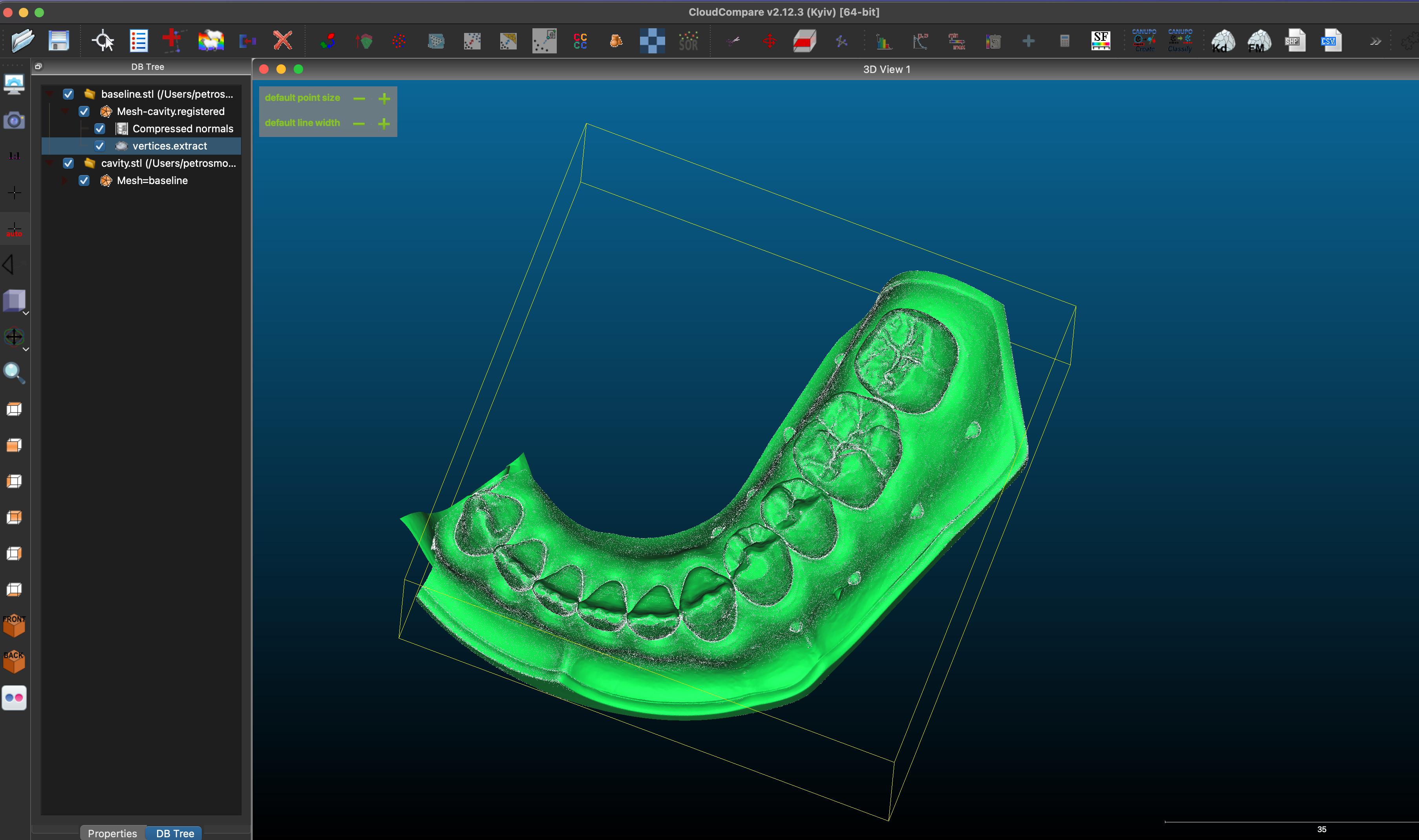

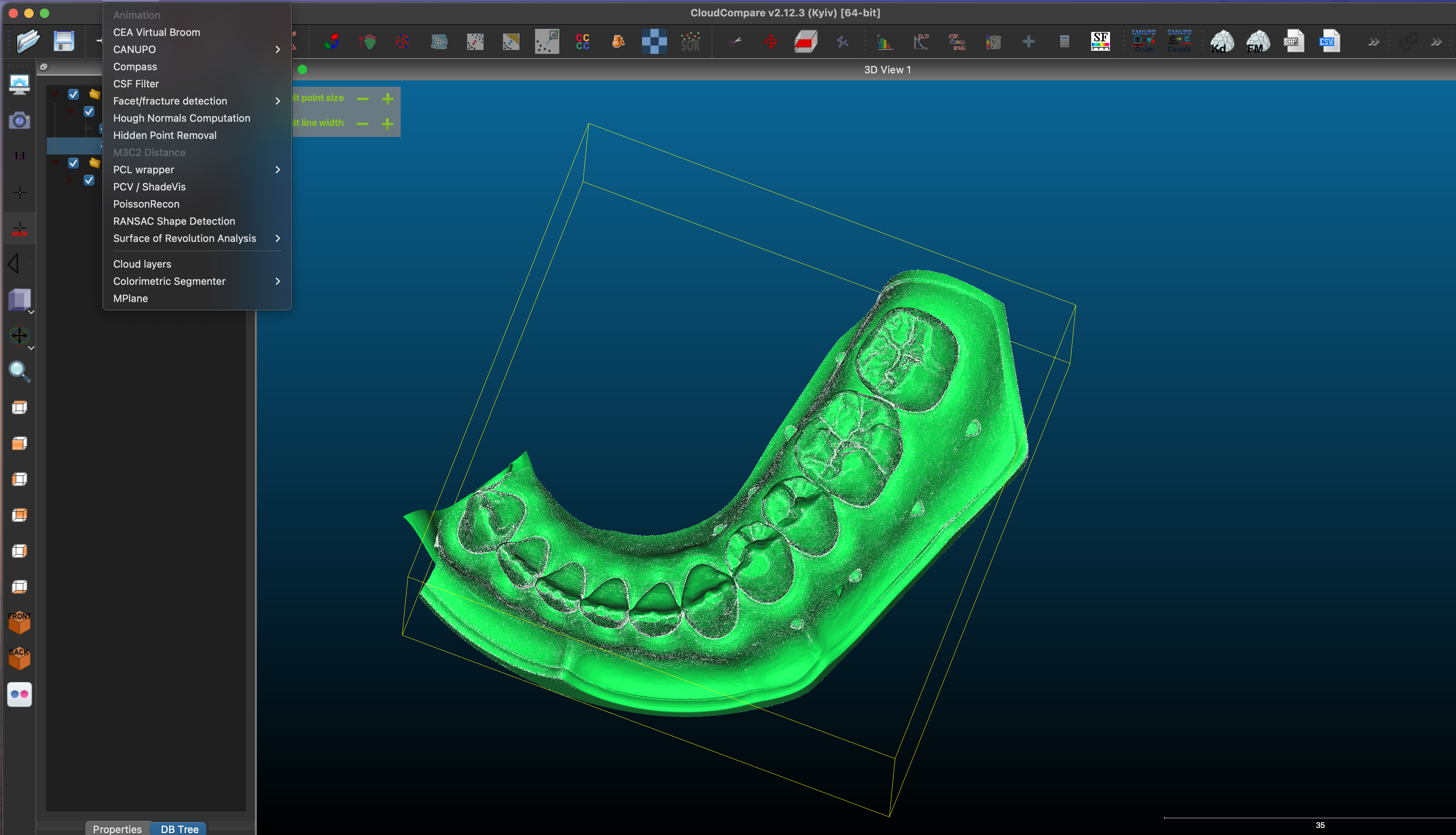

Hello, I am trying to compare to stl files regarding distance from a reference stl. I did the cloud/cloud distance and cloud/mesh distance but I can not do the qM3C2 calculation.Thank you for any comment
Screenshot 2024-01-18 at 10.03.42.png (1.99 MiB) Viewed 3300 times
Screenshot 2024-01-18 at 10.03.35.png (1.7 MiB) Viewed 3300 times
Re: qM3C2 calculation
M3C2 only works with point clouds. So you'll have to convert the meshes to (dense) point clouds (with 'Edit > Mesh > Sample points').
