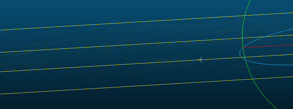

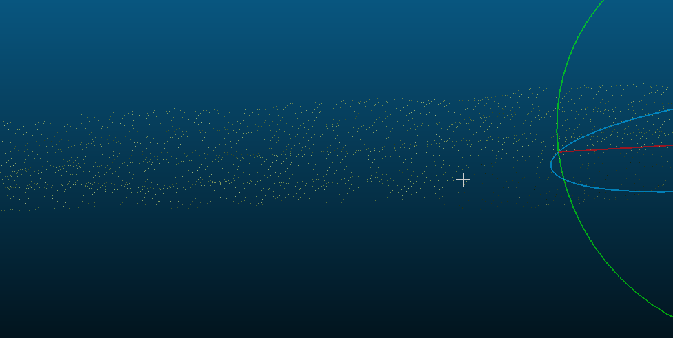

- dense cloud after sampling
- DENSE CLOUD AFTER SAMPLING.png (39.51 KiB) Viewed 17630 times
- dense cloud before sampling
- DENSE CLOUD BEFORE SAMPLING....png (43.34 KiB) Viewed 17630 times

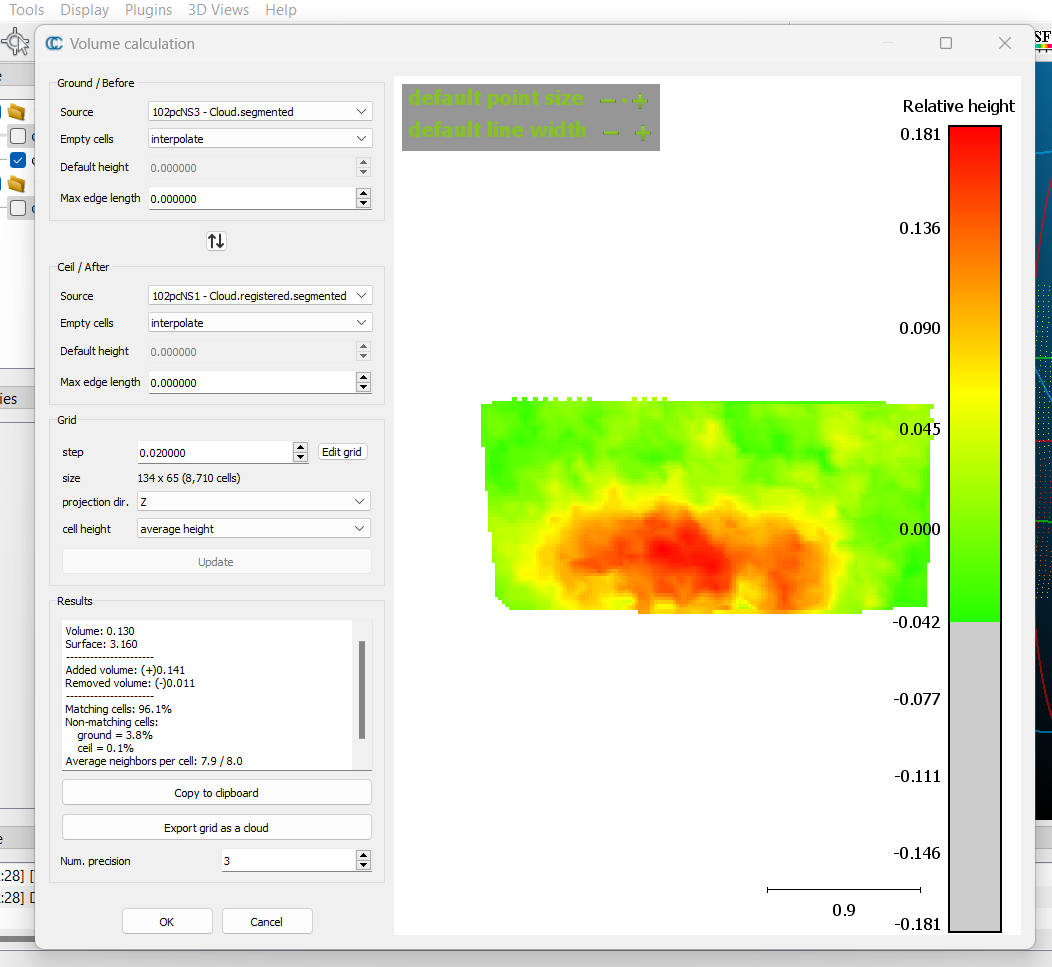

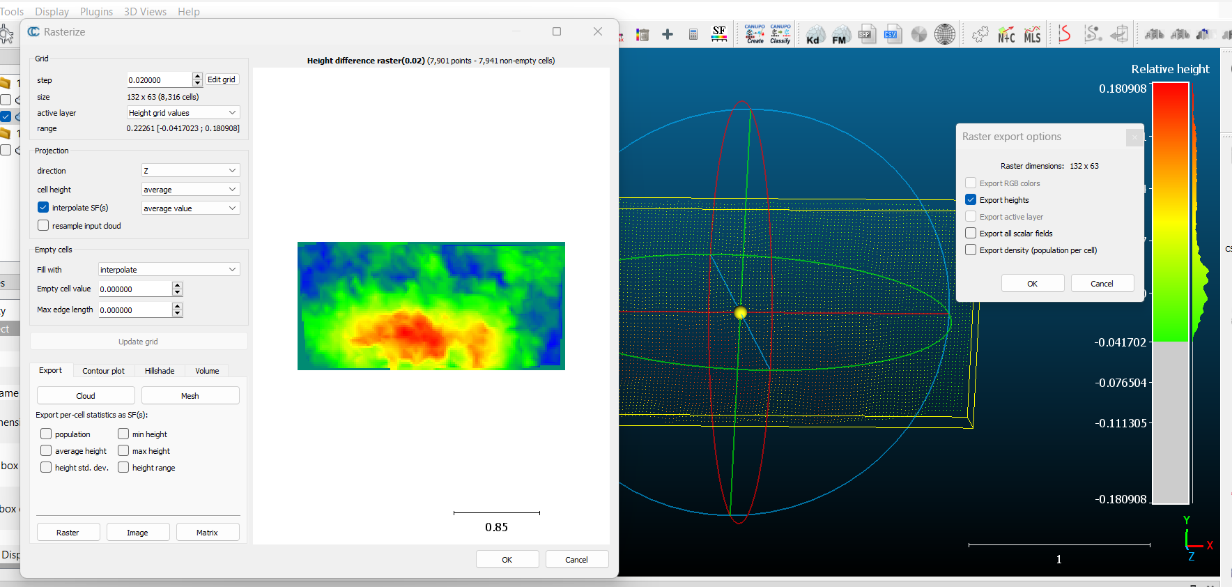

Hi Daniel, thank you for your answer.
I used the volume tool, what generated a Height difference raster, that I can visualize as a cloud, and a volume. I transformed this cloud into a raster to import to QGIS and extract more information. I am not sure if I used the right parameters to generate both the cloud and the raster. Do you think I can use the volume that the volume tool calculates as the value that I need to find? (cloud after sampling - cloud before sampling)? My goal is to compare this value with field values.
Thank you for your help.

So the parameters you used seem ok to me. The volume should be reliable looking at the statistics displayed in the Volume calculation report (matching cells percentage and 'average neighbors per cell').
For the automation, you can use the command line mode (https://www.cloudcompare.org/doc/wiki/i ... _line_mode). The -VOLUME option generates the report in a 'VolumeCalculationReport.txt' file, so you'll have to add some intelligence to your script to extract the right piece of information from it before it's overwritten by the next call.
