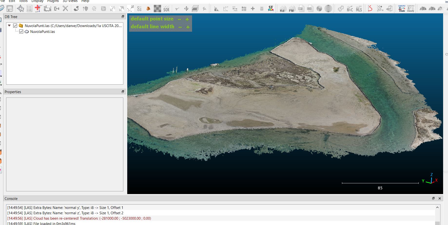

As an example, I use a very dense UAV-based point cloud (saved as .las) of a small muddy island in a channel made with photogrammetry processing.

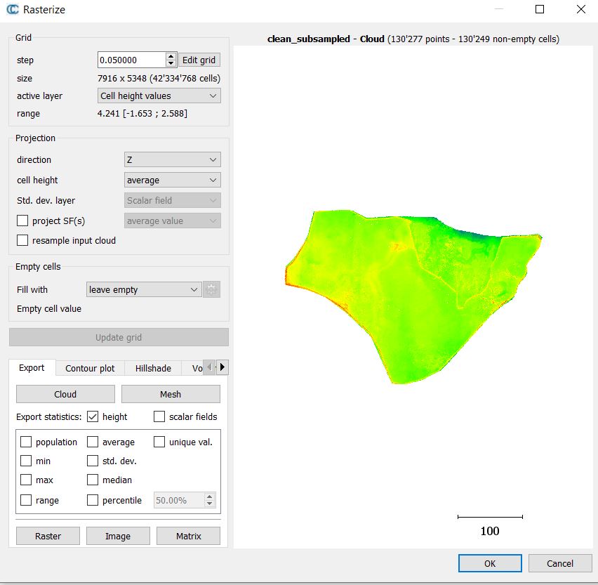

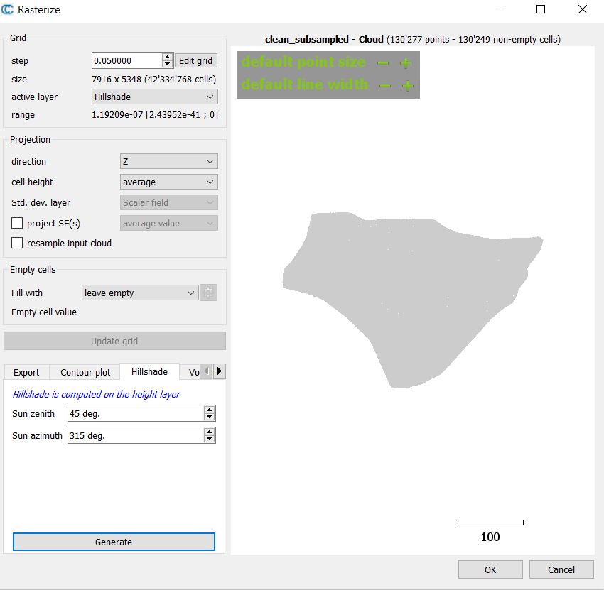

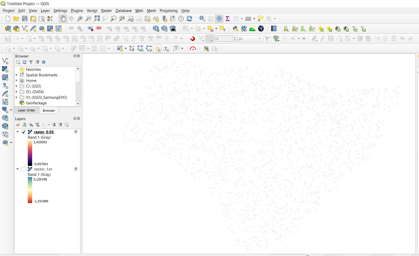

I'm trying to conver it into a raster grid with rasterize tool but if I use a small cell grid (e.g. 0.05) the generated raster seems OK in CC but when I import it to QGIS I only see isolted pixels with a very low density. Also the hillshade genereted into CC is a very flat gray image without shadows (see the attached screenshot).

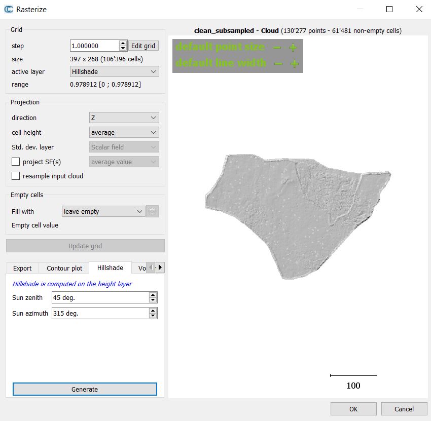

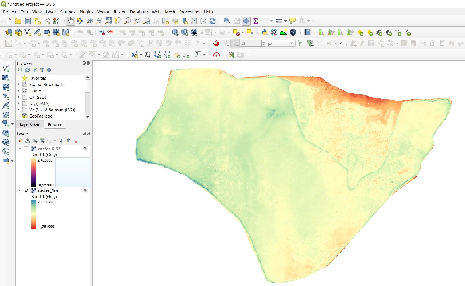

I noticed that by increasing the grid size to 1, the result seems much better as you can see, but in this case I lost too much resolution for my puroses.

- Point cloud used
- Point cloud_UAV.JPG (230.77 KiB) Viewed 6085 times
- Hillshade 1m CC
- hillshade_1m.JPG (72.16 KiB) Viewed 6085 times
- 1m grid imported into Qgis
- Qgis_import_raster_1.JPG (159.31 KiB) Viewed 6085 times
- Hillshade 0.05 CC
- hillshade_0.05.JPG (67.13 KiB) Viewed 6085 times
- 0.05m grid imported into Qgis
- Qgis_import_raster_0.05.JPG (170.43 KiB) Viewed 6085 times
- Rasterize settings used
- Rasterize_setting_0.05.JPG (79.34 KiB) Viewed 6085 times

I see that while you have a hell lot of cells with a low resolution (42 million), you only have about 130 000 non empty cells... Which means most of the cells are empty.
This explains why you see the raster as being very sparse in QGis, and the hillshade is flat as well.
Basically, you don't have enough points to generate such a fine raster. You could 'interpolate' the points to fill the empty cells, but it won't be much better than a coarser grid...
