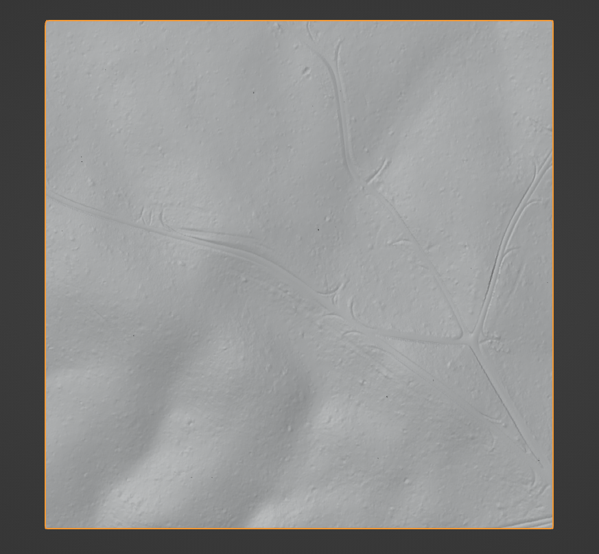

I am trying to turn a point cloud into a mesh that I can import into Blender. I haven't counted, but I have tried saving the mesh from CloudCompare around 20 times and only 2 of those times did it save a mesh that wasn't broken. I did everything exactly the same every time I saved the mesh.

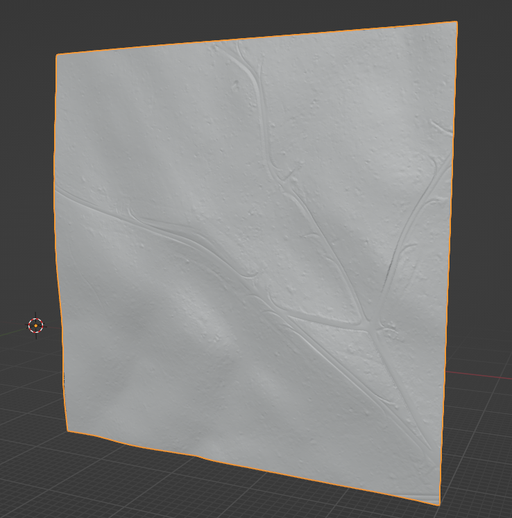

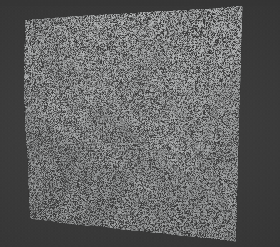

I have attached screenshots of the broken mesh. I don't think this is a problem with Blender because I have copies of the two working meshes that I saved from CloudCompare and they import completely fine every time into Blender. The broken mesh looks normal when viewed from exactly the front, but if I move the viewport angle even a slight bit, it looks completely broken.
Broken Mesh when viewing from the front:
Broken Mesh when viewing at an angle:

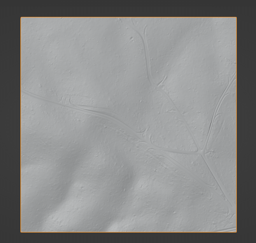

Working mesh when viewed from front:
Working mesh from angle:

Are you maybe keeping the large coordinates of the LAZ file? (i.e. without accepting to apply a Global Shift?)
Or is Blender even able to handle the large coordinates? Because what you see looks more like a display issue due to numerical inaccuracy...
