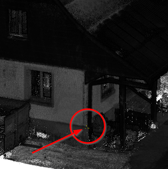

I show you some images from the past where I could see the yellow cross.
2022-04-19 .png (340.81 KiB) Viewed 3296 times

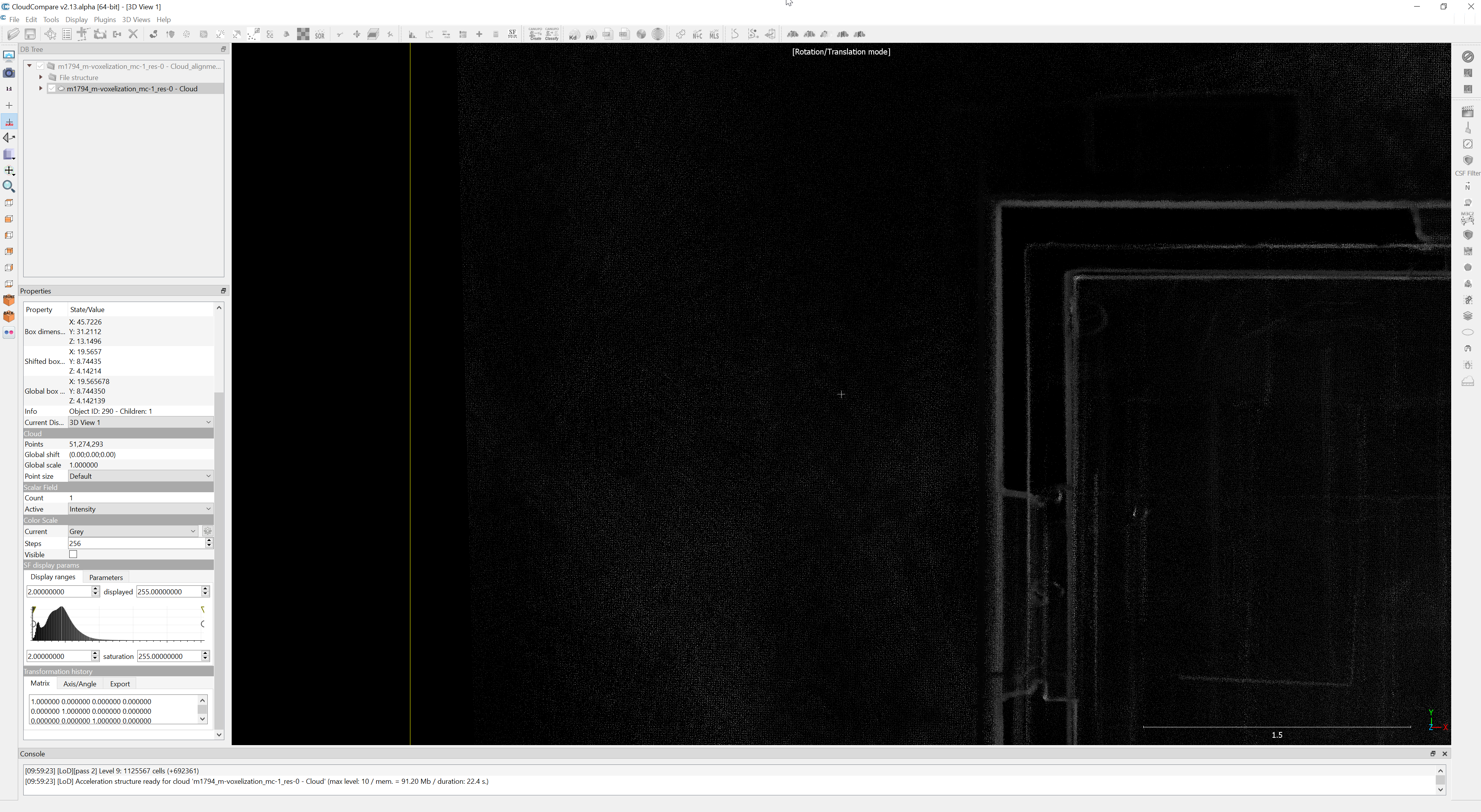

This image is current, we can see the white cross, which is always in the centre, but we can't see the yellow cross.
2022-07-18 10_29_14-CloudCompare v2.13.alpha [64-bit] - [3D View 1].png (1.92 MiB) Viewed 3296 times
Re: Display the yellow cross that marks the x,y,z coordinates
Indeed, the white cross is always in the middle of the screen (you can enable or disable it in the 'Display > Display settings' dialog.
The yellow cross is actually the position of the custom light (Display > Lights > Toggle Custom Light - shortcut F7). You can move this custom light by holding the 'CTRL' key and pressing the left mouse button (but I guess in your case you don't want to do that as you want to keep it in (0, 0, 0) ;-).
