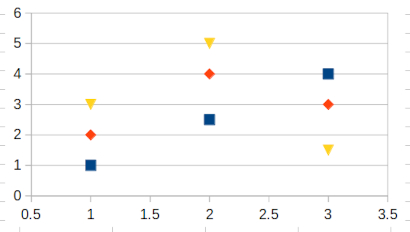

I have a csv file that contains x,y coordinates of the points to draw. (Missing the z coordinate, so the points lie in the same plane).

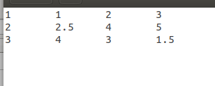

In the csv file:
the first column contains the x values;
in the following columns there are the y values all referred to the same values ​​of x of the first column.
So, for each value of x there are many values ​​of y associated with it.
My file has thousands of coordinates, but I'll give you a simplified example below to explain how the coordinates are organized.

Not in this format sadly... It can only be a couple of 'X Y' values on each line.
