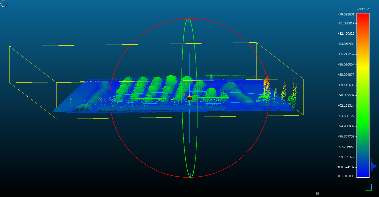

I would like to know how to get average point density, like I saw in a research paper, the author reports getting an average point density of 8 points/m2. I am currently working on my LiDAR data and would like to generate such report for presentation from my data.
Also, in the attached image from my result I a get Z-values that are negative (scalar bar to the right), I am wondering how it could possibly be that the elevation is negative.
Kindly help.

Re: Distance and average distance between point cloud
For the negative altitudes, it all depends on the coordinate system in which the points are expressed. It can be a nice geolocalized global coordinate system, in which you can expect zero to be the sea level, but it can also be a local coordinate system, centered on the sensor, in which case you cannot expect anything!
And for the point density, you will have to use the 'Tools > Others > Compute Geometric features' tool:
https://www.cloudcompare.org/doc/wiki/i ... c_features
For instance, you can choose to compute the 'Number of neighbors' and input a radius that correspond to 1 square-meter (r = 0,5641896). Or if the density is too low, you can also let CC do the maths and choose the 'Surface density' with a larger radius.
Thank you Daniel.daniel wrote: Wed Apr 27, 2022 6:29 am For the negative altitudes, it all depends on the coordinate system in which the points are expressed. It can be a nice geolocalized global coordinate system, in which you can expect zero to be the sea level, but it can also be a local coordinate system, centered on the sensor, in which case you cannot expect anything!
In the end I realize that the elevation for this location is usually below sea-level, hence the negative Z-value.
The point density is well understood.

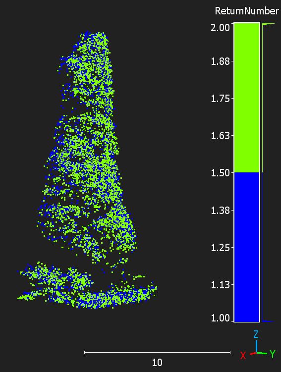

Thank you Daniel.
I do not have waveform data, but I tried the to do the first suggestion you gave but just may be I am getting something wrong.
Can I share a simple .las file with you (in the zip file) and show you exactly what I am trying to do?
Can I possibly do this with what I have (the attached)?
- lidar_EdenSmall - Cloud.zip
- (247.23 KiB) Downloaded 627 times
- Image.PNG (45.79 KiB) Viewed 12729 times
Well, in your example file, I can see a 'ReturnNumber' scalar field. But it has only 2 values:
