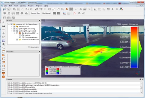

Can you help me how I can set the coloring as well as below?
There is no color information in the data from the sonar, how can I edit it?
