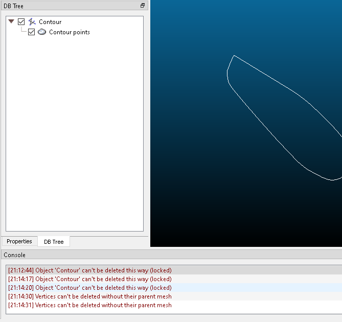

I created pointscloud contour
Tools >> Fit >> 2d polygon (facet)
then I cloned the the contour alone
Now I can not delete this cloned contour nor move it to new group folder
I got this mesg
Object 'Contour' can't be deleted this way (locked) ..
I attached example, just clone contour then try to delete it

Ah, good catch! That's fixed (in the code). It will be available in the next beta release.
