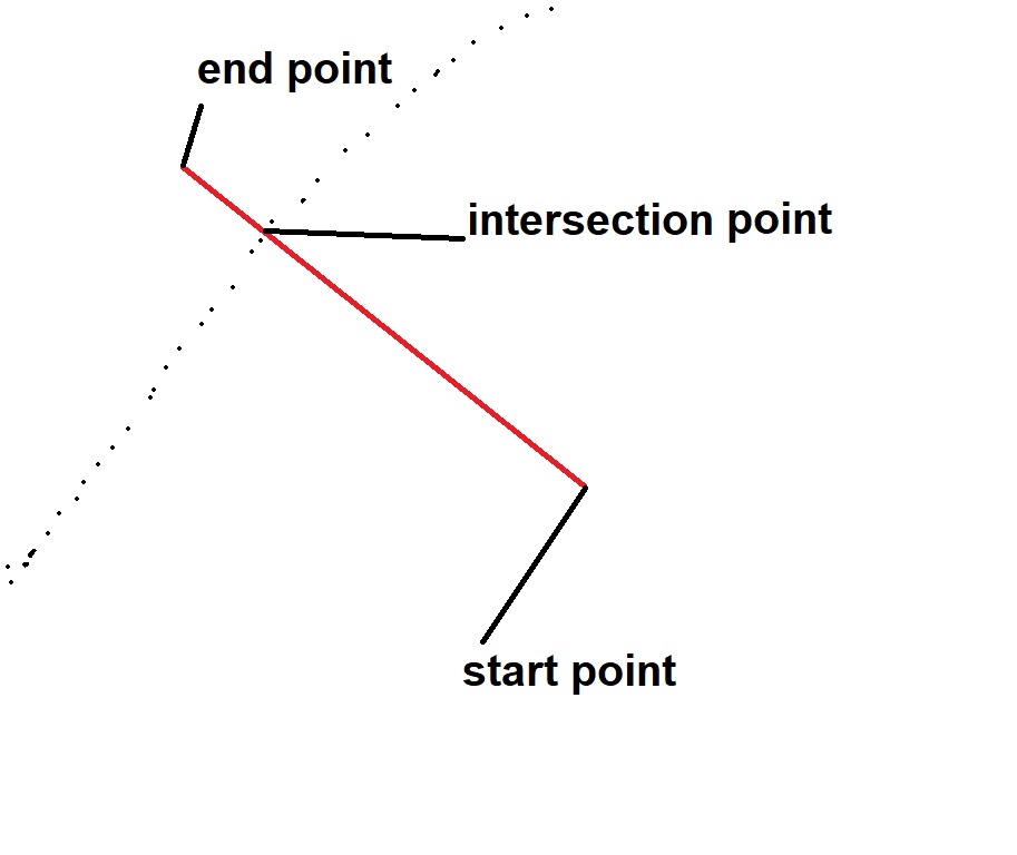

i dont know if i will be able to show in a picture, but I will try.
The input will be several lines, coming from dxf for example, and a point cloud.
The idea is to find the intersection as shows the attached picture
![Image]()
- Untitled.jpg (45.52 KiB) Viewed 22355 times
Re: intersection of lines and point clouds
Ah! Then maybe one option would be to sample points on the (poly)lines (Edit > Polyline > Sample points) and then compute the distances between the resulting cloud and the real point cloud. Hopefully the point with the smallest distance should be the closest to the real intersection point...

i found the way to do it, actually I was busy, but yesterday it comes back to my mind, and the solution its easy to do it.
M3C2 distances its key, just need to use the "tunnel" cloud and the lines import as a cloud.
The cloud of the lines (bolts) needs to be import in ASCII format with XYZ of the start point and the vector direction like normal.
After in M3C2 plugin, it can be calculate using the normal direction towards the tunnel cloud
