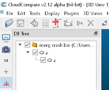

When pointscloud is a sub of another pointscloud (sub-folder), CC crashes during merge apply
please check the attached BIN file
merg crash.png (25.93 KiB) Viewed 3830 times

Ah, good catch.
I fixed this. It will be available in the next (beta) release.
