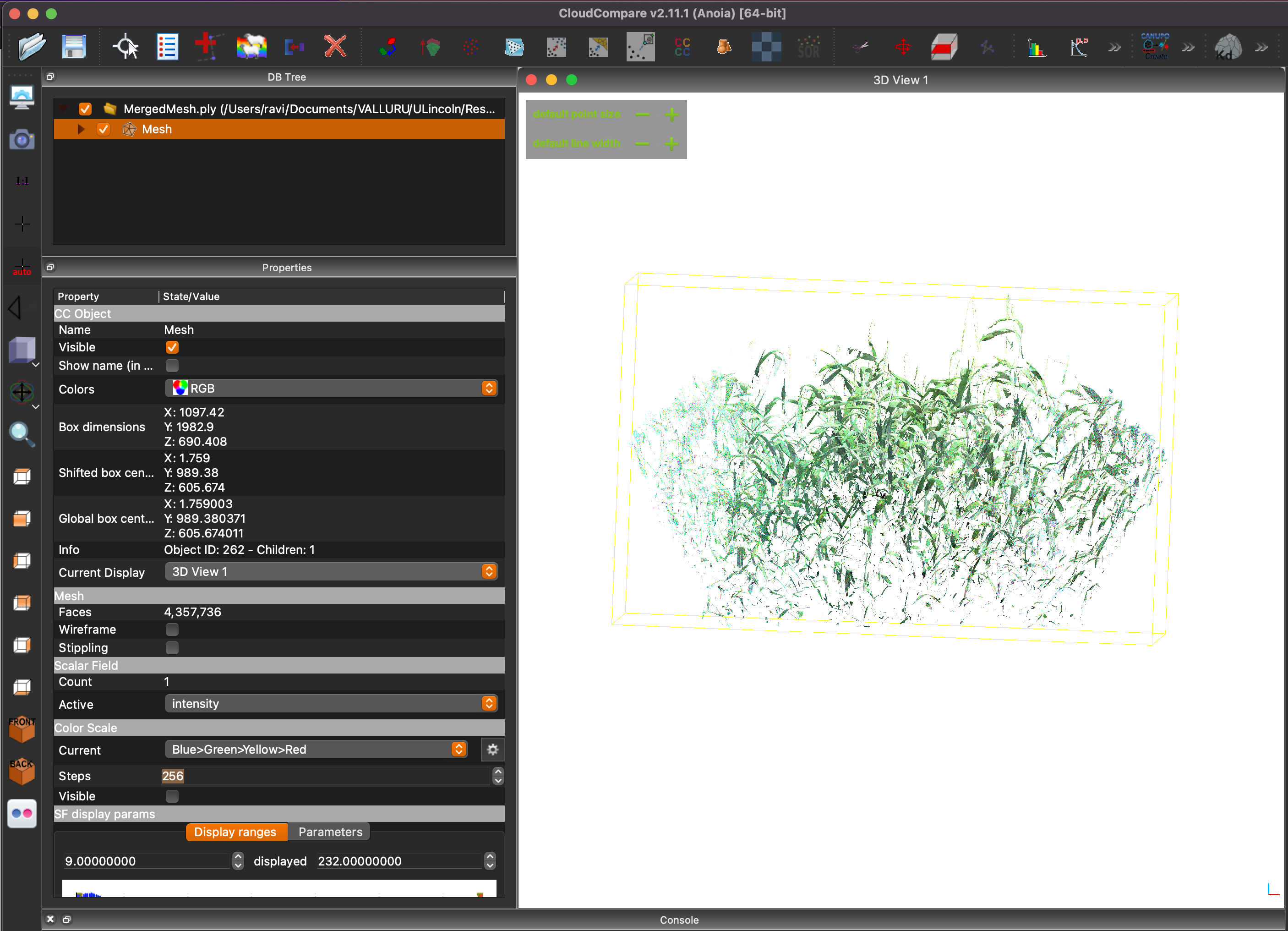

Thank you, Daniel. I do not see any option "Vertices" below the mesh. I have attached a screenshot of my CC. Also, I want the XYZ coordinates for every triangular in the mesh BUT not the XYZ coordinates of the point cloud.

I just found "Vertices" below the mesh. However, it is showing only one XYZ coordinate value: Example below:
-365.65100098 855.71899414 336.13699341 145 84 196 11.000000
I expect that every triangle has 3 sets of XYZ coordinates to represent one triangle. I would like to get these 3 sets of XYZ coordinates for all triangles. Many thanks.
Re: Extract coordinates for faces or triangles
'Modern' meshes share the vertices among triangles (to reduce the memory consumption, and to manage the connectivity between the triangles...
If you want 3 vertices by triangle, you can export the mesh to the 'STL ascii' format (export to STL, and then choose 'ASCII' mode). You'll be able to open the file and you'll see the 3 vertices that compose each triangle in a human readable format.

Thank you, Dani. It worked. I can see XYZ values for 3 vertices for all triangles in the mesh. many thanks.
