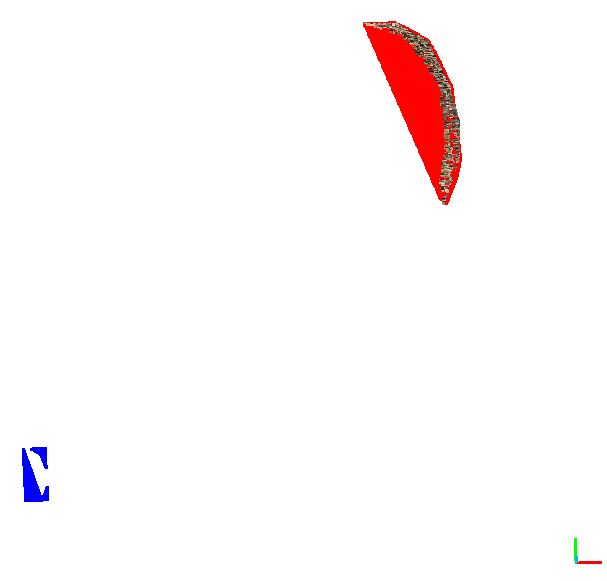

Which default altitude have you set for the cells that can't be interpolated? Because in this case, you might have points very far from the original cloud (that's what I have on my side):
Well, it only slightly slows the computation anyway, since there are not that many points. And in my case, in both cases it takes either 0.05 s. or 0.27s. So quite fast. Maybe I'm missing a step?
