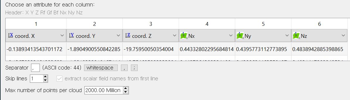

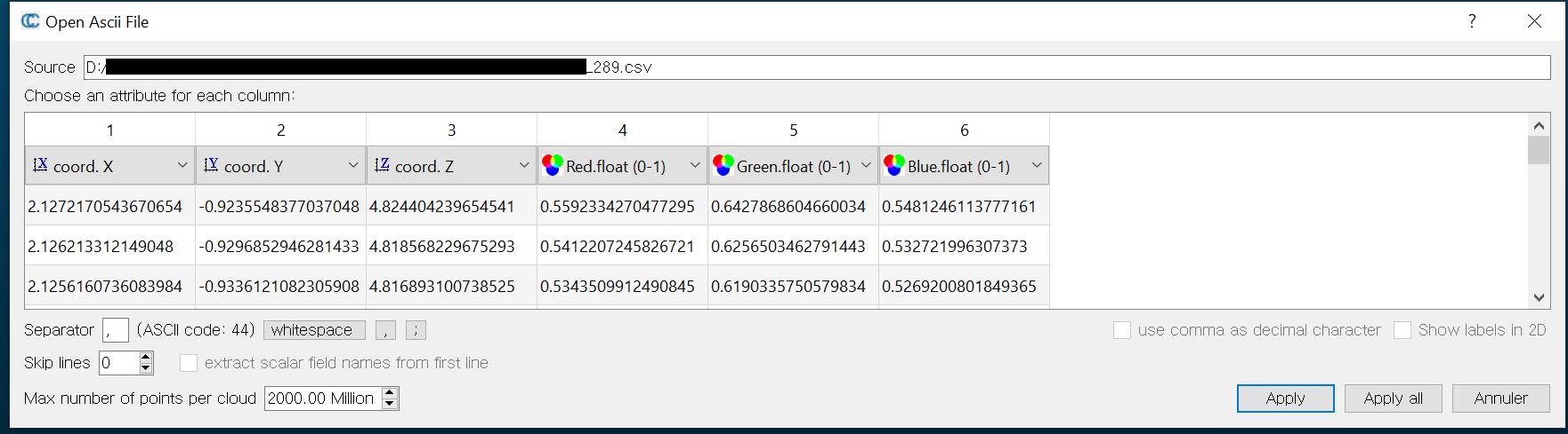

Using CC in Command Line mode, to convert CSV (Ascii) data to PLY (Binary_BE) file format, it seems we can't define the attribute for each column. Those Attribute choice are missing for each column.
Actually i want to define Column like that, but the Color is converted to Normal vector instead:
CloudCompare.exe -SILENT -O D:/CSV/export_0.csv -C_EXPORT_FMT PLY -PLY_EXPORT_FMT BINARY_BE -NO_TIMESTAMP -SAVE_CLOUDS -CLEAR
Is there a solution to this ? Maybe via Python ?

Is there is no way to define the Retargeting of R G B Float 0-1 via the a Batch File ?
Here is the code i use in a Bat file:
Code: Select all
CloudCompare.exe -SILENT -O C:/CSV/export_0.csv -C_EXPORT_FMT PLY -PLY_EXPORT_FMT BINARY_LE -NO_TIMESTAMP -SAVE_CLOUDS -CLEAR
CloudCompare.exe -SILENT -O C:/CSV/export_1.csv -C_EXPORT_FMT PLY -PLY_EXPORT_FMT BINARY_LE -NO_TIMESTAMP -SAVE_CLOUDS -CLEAR
and so on
smoluck
Posts: 15
Joined: Mon Dec 02, 2019 2:15 am
Re: Command Line Attribute choice missing for each column when batch open CSV to PLY.
Post by smoluck »
What i want is defining the 4 to 6 Column to be that way once i launch the command line Bat file.
Actually when i use the Command Line, that Popup doesn't show up.
And at the end the Output PLY file is just White . There is no Color saved.
Ah, float color components... They are generally mixed with normals when CC attempts to automatically detect the role of each column. And if you add the header, it will try to load them as 0-255 color components. I think that's clearly a limitation for now.

is that this header ?
Code: Select all
//X Y Z Rf Gf Bf Nx Ny Nz
smoluck
Posts: 15
Post by smoluck »
even with this header, it still look at wrong values.
Ah but once again, since it's float colors, I believe it won't work anyway...
