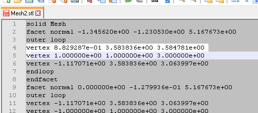

Attached 2 simple STL ASCII file to show this issue
Exchanging vertices( line 4 with line5) will change normal without any chance that CC recalculate normal correctly

This 'direct vertex order' is normally a convention. And the volume computation algorithms, just as the normal computation algorithm, assumes all triangles are properly 'oriented' (mind that this algorithm doesn't use the normals, just the vertices).
Of course finding flipped triangles is possible. I guess any motivated contributor can do it ;). I'm personally not sure to see the point of duplicating the effort in CC since there are much better tools to process meshes (Blender, Meshlab, etc.). But such a contribution will be welcome of course.
