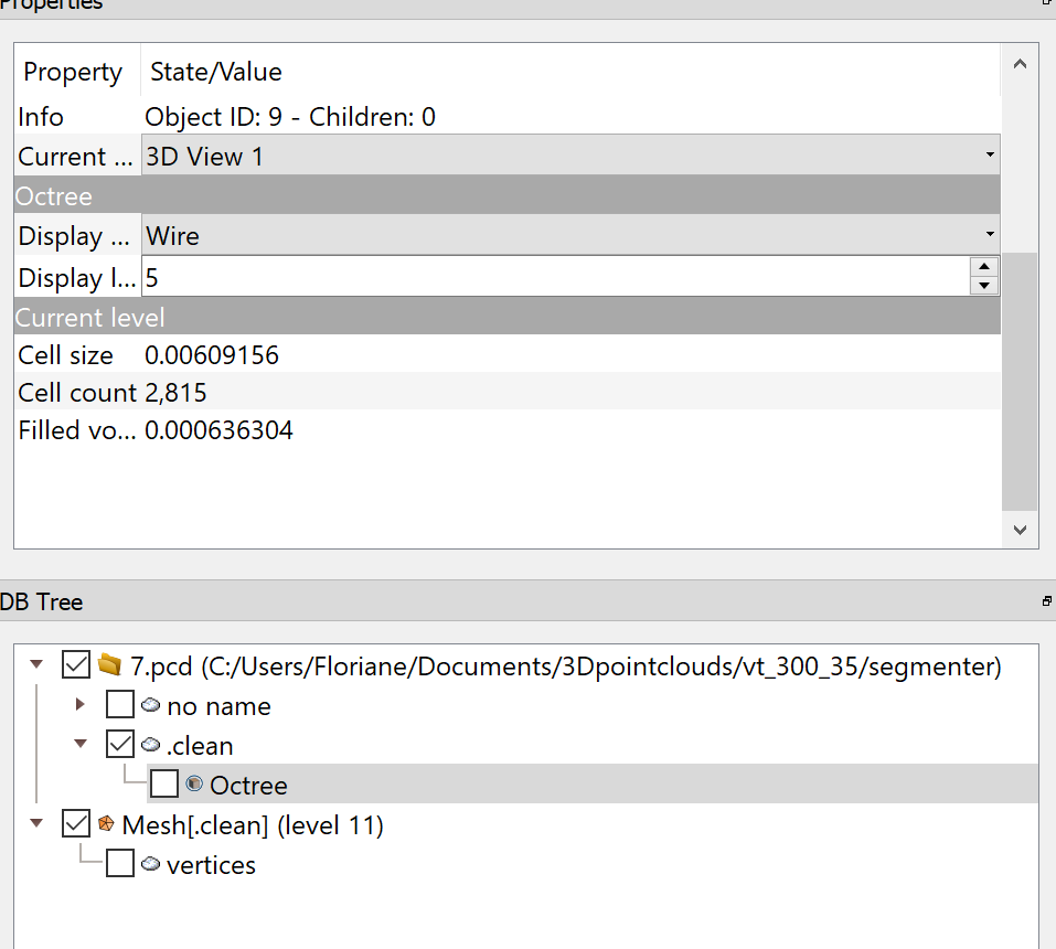

Hi! I am doing a master's degree and I have been using Cloudcompare but I got some questions I can't seem to find answers to. it is about octrees. So i compute de Poisson reconstruction, I get the mesh and octree. When I click on the octree I can see octree's parameters but they are some I can't explain. I was supposed to compute the volume of my pointcloud so I used filled volume in octree parameters. But when I change display level the filled volume changes. The higher the display level the lower the filled volume. So I'd like to understand what exactly the filled volume is. Thanks

So this is the 'volume' of the octree (= sum of the individual volume of each (square) cells in which points are present). The greater/deeper the octree level is, the smaller the cells are. Hence the total volume generally decreases.
Anyway, this is definitely not a reliable way to measure the volume represented by a point cloud.
If you have a 2.5D cloud, you should definitely take a look at the 'Tools > Volume > Compute 2.5D volume' tool (https://www.cloudcompare.org/doc/wiki/i ... .5D_Volume).
Otherwise, you can try to compute a closed mesh (with the Poisson Surface Reconstruction plugin typically - and 'Dirichlet' boundaries) so as to obtain a closed mesh. You can then ask CC to compute the volume of the mesh (but it needs to be good AND closed).
