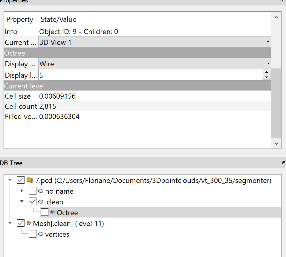

Hi! I am doing a master's degree and I have been using Cloudcompare but I got some questions I can't seem to find answers to. it is about octrees. So i compute de Poisson reconstruction, I get the mesh and octree. When I click on the octree I can see octree's parameters but they are some I can't explain. I was supposed to compute the volume of my pointcloud so I used filled volume in octree parameters. But when I change display level the filled volume changes. The higher the display level the lower the filled volume. So I'd like to understand what exactly the filled volume is. Thanks
Re: Octree's parameter filled volume
So this is the 'volume' of the octree (= sum of the individual volume of each (square) cells in which points are present). The greater/deeper the octree level is, the smaller the cells are. Hence the total volume generally decreases.
Anyway, this is definitely not a reliable way to measure the volume represented by a point cloud.
If you have a 2.5D cloud, you should definitely take a look at the 'Tools > Volume > Compute 2.5D volume' tool (https://www.cloudcompare.org/doc/wiki/i ... .5D_Volume).
Otherwise, you can try to compute a closed mesh (with the Poisson Surface Reconstruction plugin typically - and 'Dirichlet' boundaries) so as to obtain a closed mesh. You can then ask CC to compute the volume of the mesh (but it needs to be good AND closed).
