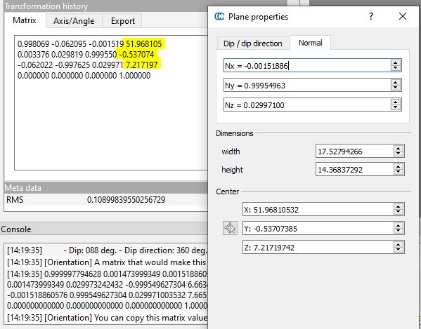

Post by WargodHernandez »
I don't think it is displayed anywhere currently...
so for now you would need to copy the x,y,z translation from the transformation history and the normal values from the plane properties window
and then take those values into an online calculator like www.symbolab.com/solver/vector-dot-product-calculator
The link to the online calculator already has the corresponding values entered from the image above.
Also can be done in MS Excel pretty easy.
And finally we could probably add it to the Plane Properties window, but this isn't done yet and not sure when it would be added

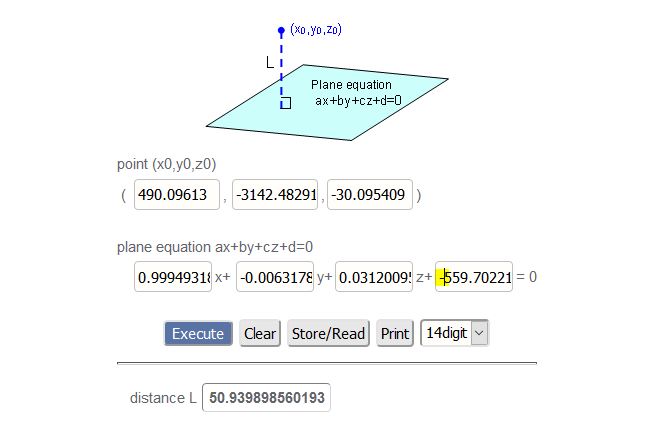

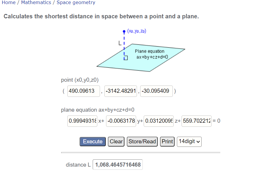

Ahhh ok thank you that makes more sense now! I am basically trying to define the equation of the plane to check some point-to-plane distances we are calculating using another online calculator for a point cloud. But what's weird is based on the equation of the plane that I extracted using that method, Im getting really different number for point-to-plane measurements compared to using the cloud to mesh distance in CloudCompare. When I use the cloud to mesh distance for a specific point I get 51.02 (more reasonable for what Im doing), when I use the plane equation with the other point to plane calculator I get 1068.464. Does this have to do with the origin?

Post by jwinkler »
Good to know, for what I was doing I couldnt see a difference between the cloud to mesh distance and the point to mesh calculation when I ran each one. See the link below to the calculator I used. The values in the snip are the ones I retrieved from my best fit plane and point in cloud compare.
https://keisan.casio.com/exec/system/1223614315

//point to plane distance: d = (a0*x+a1*y+a2*z - a3) / sqrt(a0^2+a1^2+a2^2) **USED in Cloud Compare
**USED in linked website
main difference is
(a0*x+a1*y+a2*z - a3) vs abs((a0*x+a1*y+a2*z + a3))
So it appears it is related to the sign of the const value
https://www.mathepower.com/en/distancepointplane.php Calculates with the same answer as cloud compare, honestly not sure which is correct without further investigation

Post by jwinkler »
That must be it, several of the other online calculators show the formula as having the absolute value of the numerator but the number from cloudcompare definitely makes more sense. Thanks for all of your help with this!
