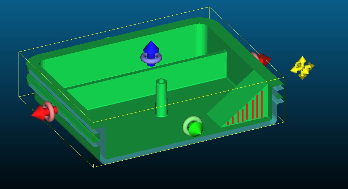

Firstly, thank you everyone who have worked so hard on this project and for making it free to use.

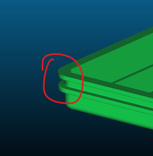

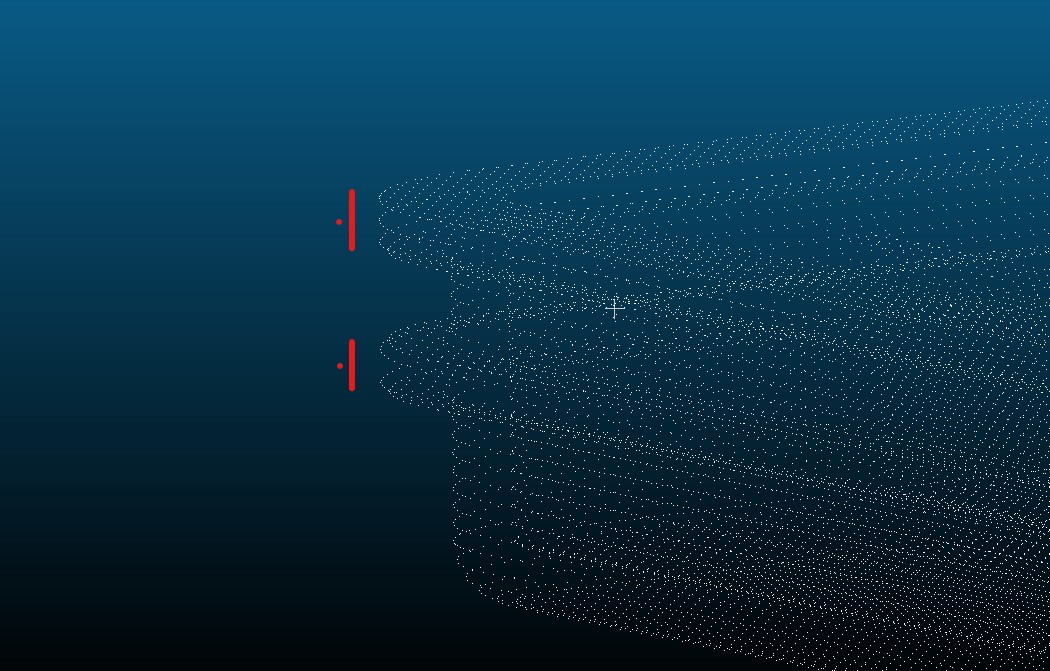

The idea is to get a 3D-(wall)thickness analysis based on difference in z-coordinate(single direction). I've tried the 2.5D volume option which successfully gives me the heatmap based on the total height difference, but I don't know how to extract this (image 1,2) thickness. Is it possible to do so?
Re: 3D (wall)thickness Analysis
Ah, sadly none of the 2.5D approaches (Volume computation, Raster tool, etc.) would work in this case... Apart from manual picking (with the 'Point picking tool in 'distance mode) I don't see how you can easily extract this information...
