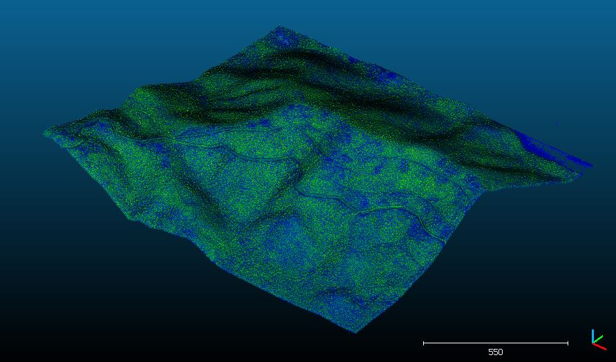

On my side, with the latest version (2.12.alpha) I was able to load the file without any issue:

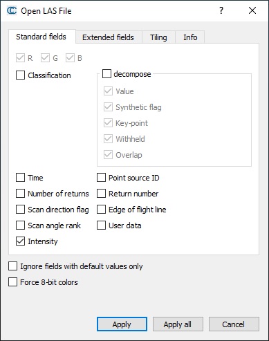

To load the full data (points and LAS fields), you'll need about 15Gb of free memory (in addition to what is already used by Windows, etc.). Then the optional LoD structure will use 2 or 3 Gb.
To load this file on your side, you can try to load only one LAS field ('Intensity' for instance). This will reduce the necessary memory to 3Gb!

Thanks Daniel! I think I had too many "things" checked, that might be what kept crashing things. When I only checked the box you advised, it opened correctly for the first time. Unfortunately this is just one piece of a 50 or 60 piece puzzle. So I will continue to look around for the entire Island, even though I do not know if it exists, I haven't had much luck over the past month, but I'll keep looking, there must be one somewhere. Thanks again, for the great advice!
