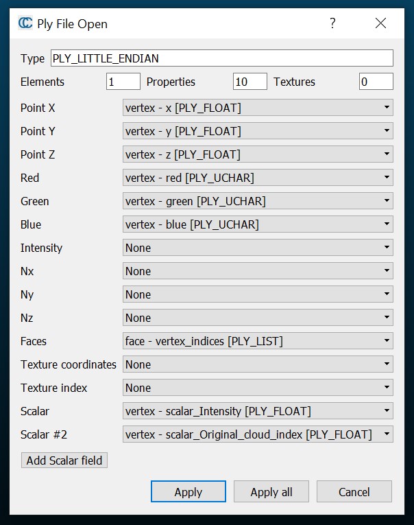

Here is the file from the poissonrecon.exe being imported into CC. Notice 2 scalar fields. (neither works as expected).

Re: Automating common workflows?
So no density scalar field?
