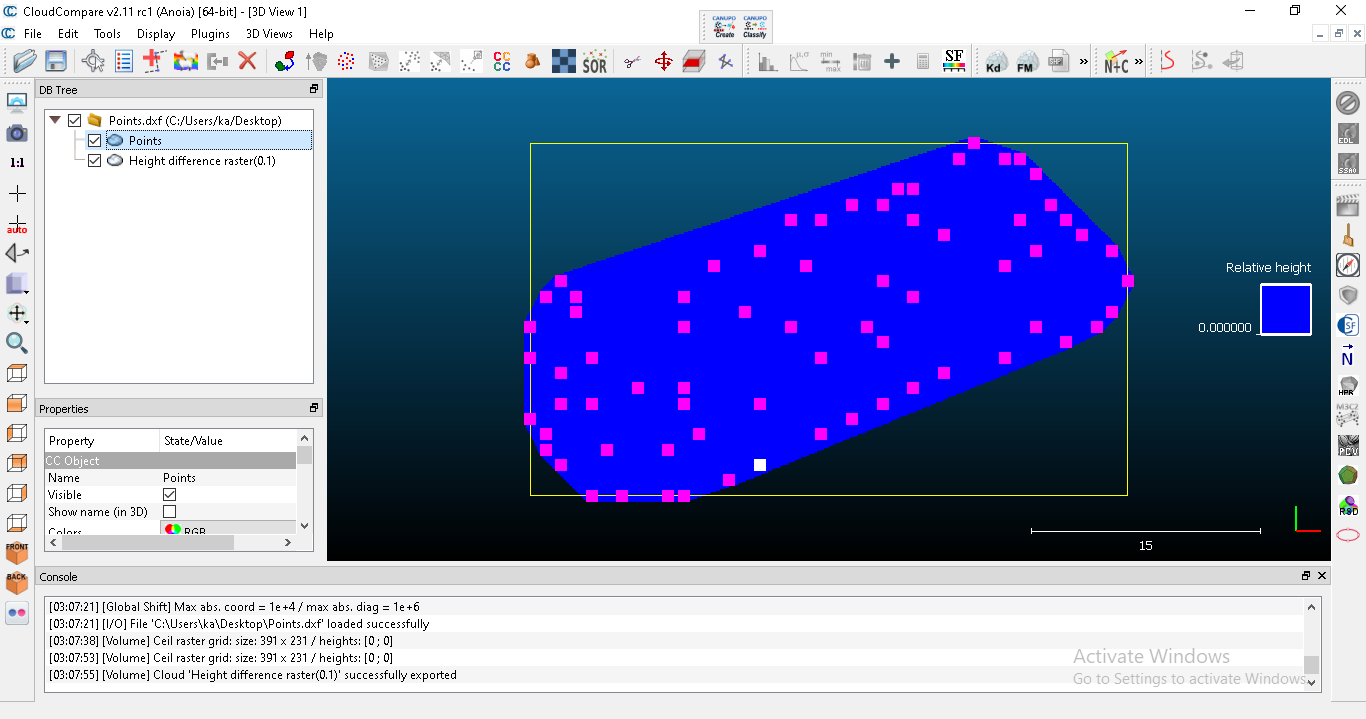

I am trying to find area and volume of simple XYZ points
I got wrong area because convex hull code make larger perimeter with out any way to correct the hull manually (segment tool does not help)

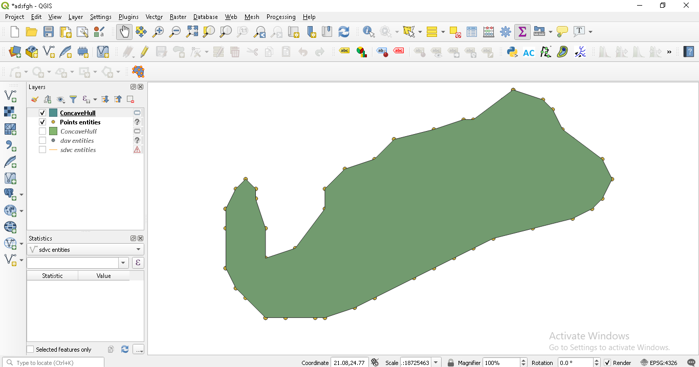

I can get nice hull with QGIS very easily
but I want same hull result in CC for correct are and volume

How did you generate the 'hull' here?
And what are these white points? (there are not a lot ;)

hulls is generated by CC prior to any 2.5D volume calculation or even mesh
but as you can compare with hull by QGIS
CC hull is larger and can make area and volume +20% ore more (stockpile calculation)

here I attacked example

Are you expecting CC to produce a concave hull? I thought we only have convex hull generation. That would explain the difference
Re: wrong area and volume (larger convex hull)
Well, my question was really "how" did you generate the hull? With the 'Edit > Fit > Facet' tool?
Because there's a way to generate a concave hull, but not as a polygon. And mind also that the 'Facet' tool doesn't generate a flat polygon, but a 2.5D one.
Anyway, I agree with Chris, here it definitely looks like a convex hull, and not a concave one.
